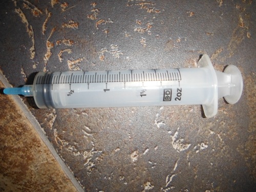

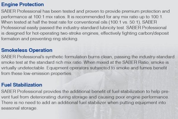

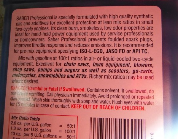

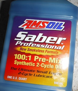

    IMO
    The synthetics lubricate better , in turn the saw runs cooler.
    I went with Amsoil Saber & mix 40:1
    saw manufacturer ( with the EPA pressuring them) calls for 50:1
    Smokeless, has fuel stabilizer in it, less carbon build up.
    If you are going to run a 50:1 mix, synthetic would be my 1st choice
    40:1 mix can go in all my 2 cycle stuff, burns clean, no smoke & no odor
