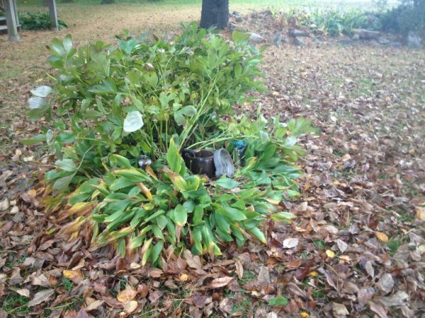

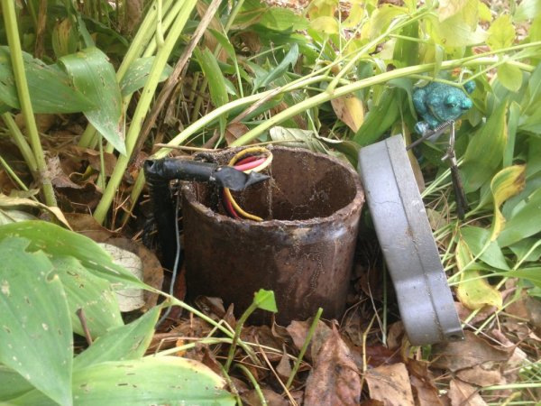

    I just took the cap off the well. I was wrong. The water is not coming out of the top of the well. We have some type of plants around the well and it just looked like that I guess. Now that I have the top off I can see the water is actually coming up out of the ground right next to the well. So the power wire on on the side of the well pipe is protected with a piece if small plastic pipe right up to the underside of cap. The water was being forced up that little pipe and it was coming out if where it ended just under the cap, does that explanation make sense? Here is a pic or two.
    I think it is the line between the well and house leaking right next to outside of well pipe. I'm thinking of firing up the backhoe and getting it done. It's either do that or enjoy the day and do it tomorrow when everything is open. Probably only need things from Lowes though. And they are open today.

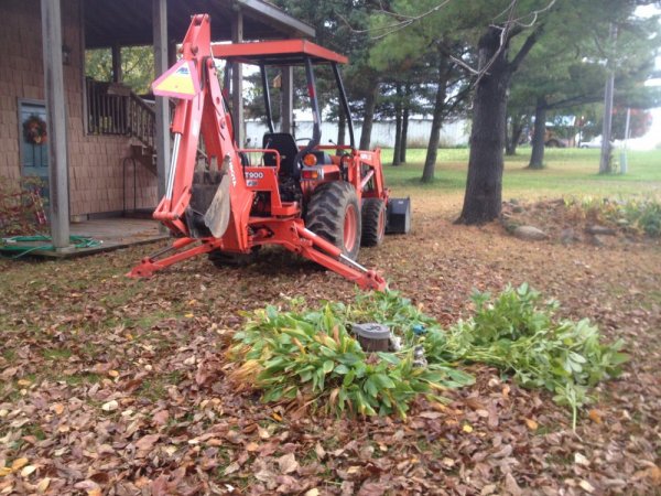

    The backhoe is in position. I'm going to stop and bring some wood in first though. Get the boiler going. It is kinda cold, wet, and crappy out right now and the boiler and tank are coming down in temp after the showers.

    Definitely wait until tomorrow when you can access to whatever you need. I'd be looking @ some sort of protection for the wiring while you have the trench open. I would replace the line if it is more than 10 years old. Sounds like you have a leaking coupler or elbow @ the pitless adapter. Also, while you have the trench open think about putting a inch or two of styrofoam insulation on top of the water line before you backfill the trench. That way the frost will not get down to the waterline which prevents heaving of the line or a rock punching the line from frost shift. The styro is cheap insurance for the line.
