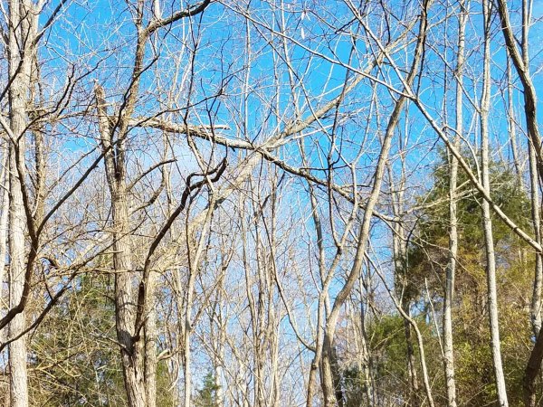

    Okay, I'm no cowboy, real woodsmam or officially trained arborist. I can just about tie my shoes and an occasional Christmas bow without help, but I have no clue about what knot I should use to pull a black locust limb out so I can drop the tree. :emb:
    I know I need a weighted throwing line so I can get the rope over the limb, but how do I knot the rope once its over the limb?
    I apologize for my ignorance but at least I know enough to ask the right questions....I think!:rofl: :lol:

    Not sure....maybe by hand, maybe my BX. But its a bit spooky getting the U.L.A.V. up there because of the side slope. I may be able to borrow a come-along and pull it.

    What is the diameter of that limb ?
    I don't know if I'm looking at something 12" butt diameter ×40' long . Or 4" dia ×15' long.

    What do you have for ropes?
    Do you have any other pics that go from the ground. ??

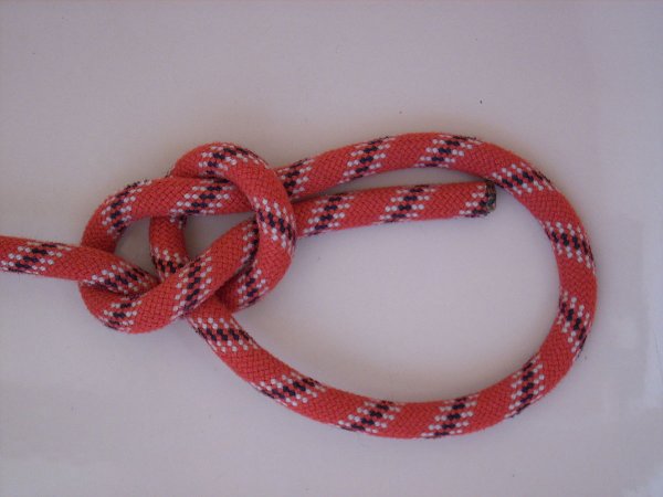

    For your task, depending on what kind of rope you're using, I'd recommend making a loop at one end using a knot such as this bowline knot, then use a thrown or weight to get a small line up and over the branch. Once the small line is over the branch, tie it off on the bowline loop, pull it up over the branch and pull the other end of the bowline rope through the loop, and choke the branch.....

    For all the benefit of the kids in class you leave your tail longer when putting that knot to work right?;)

    this was just a generic pic from the interwebz.....I have permanent loops in my bull ropes. But yes, you'd want a longer tail when using a removable bowline knot, and I'd recommend a figure 8 tied in that tail as well....
