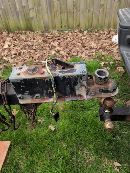

    My son bought a boat and sent me this pic of his hitch. Never saw one like this. Anyone know why it's designed this way? IMG_20250414_101811.jpg

    I see a breakaway cable on top which tells me trailer has brakes but a 4 wire plug so not wired for brakes right?

    Think I have it figured out.....surge brakes. Never heard of them.

    You're right, surge brakes. Used on boat trailers because the water submersion is hard on electric trailer brakes.

    It is a surge brake. Our old tent trailer had it. When the break away cable breaks, the trailer applies its own brakes.

    Surge brakes work great for their purpose but I doubt those are working. Looks like (and I may be reading the picture wrong) the trailer ball hitch portion has been welded to the cylinder housing rendering the assembly inoperable! If so, the setup could be illegal. Might want to at least investigate that. Replacement surge assemblies can be easily found on line. Boat trailer brakes are always a can of worms!

    Surge brakes that have been disabled by welding.
    1) because they do not work well
    2) because when they do actually work they suck
    I will go out on a limb though and say the break away probably still works though. They were probably tired of the trailer being jerky when driving.

    Thanks for all the input guys. I'd just never seen those before. Now I know all about surge brakes and how they work.

    Looks like an old U-haul hitch. The lever on top is the disengage lock so you can back up.
