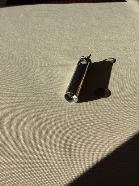

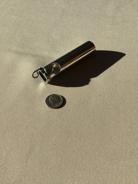

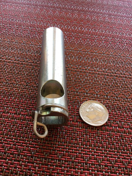

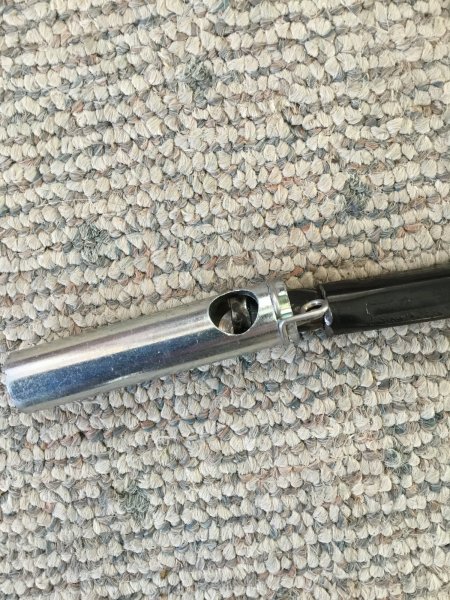

    I found this in my truck door’s side pocket. No idea where it came from. What is this?
    Truck is an F350, and had been to a shop for a rear brake job, so I’m thinking this part is from some other job they were doing, but they didn’t recognize it when we asked.

    No idea what it is but I don't think it came from the truck.
    Could someone else have put it there? Anyone borrow the truck?

    first thought was a dog whistle

    Hasn’t been lent out in a while. My wife gets to drive it more often than I do (I have a long commute). Hmmmm.

    No idea..... have an F250, don't recognize it.

    maybe a tool for the proportion valve if they bled the brakes.

    I replaced all four calipers along with lines and hose assemblies on my F350 single rear wheel. I don't remember seeing anything like that. Maybe it fell out of the tech's pocket?

    Me too!
    I was nearly positive the other was a dime

    One, thin, dime.

    How in the world did you come up with a k-nibbling pin for a relative bearing grease gun in your truck? Flamestead

    23,471
    150,926
    About the only thing I have never worked on is an airplane...and I have no idea what that is...certainly never seen one on an F350

    Just for the heck of it, blow through it and see what happens:sherlock:

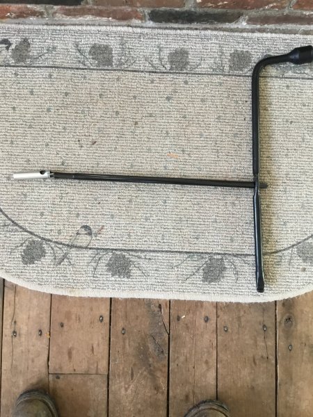

    It’s for the spare tire winch. Goes between the crank rod and winch they have several different patterns like a locking lug nut

    Wow - check this out...
    The round hole must just be there to allow gunch to fall out and not gum up the works.
    Check this out...
    That damm thing wouldn’t have been in the truck when needed (would have been in my scrap pile). Warner , pm me an address and I’ll send you some maple syrup!

    It’s not a bad idea to lower the spare from time to time to ensure things aren’t froze up when you need it.

    Wow...I better see if the all parts are there on mine! :eek:

    I bought my 350 off Geauga Co Job and Family Services. They had the spare in the bed where is still rides if I'm not hauling wood. I think the mechanism that lowers the thing is rotted from the salt they used on their lot. The bed was pretty bad, I bought a new take off over in Defiance a few weeks after I got the truck home.
