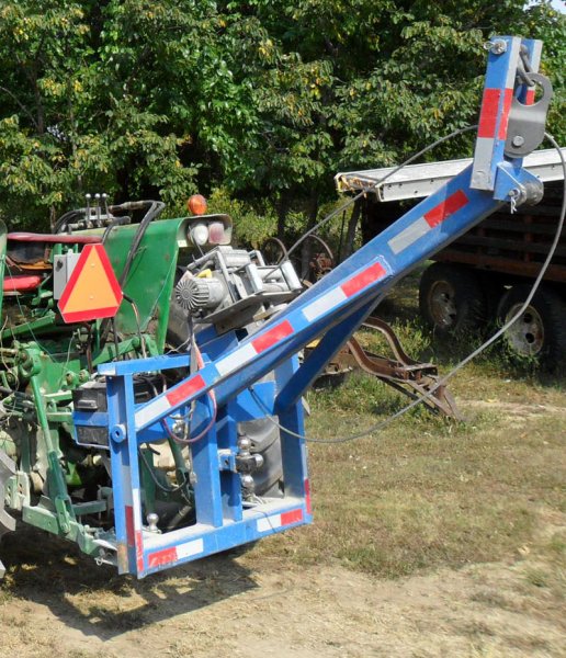

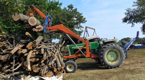

    I have a 70 hp Oliver 1655. (Go figure!) I have fluid filled tires which make dirt/loader work much easier. I have a boom attachment for the loader which will reach 29' in the air. Great for lifting trusses, setting steel panels on roofs, with the winch attached can service my well/replace the pump. The pallet forks with grapple & the skidding boom on the back make wood collecting so much easier. I can just pick up trees with trunks up to 18-20" with forks/grapple and carry them out to an open area to make cutting/processing more convenient. It will move/load logs 3'dia by 14' long. The winch allow me to retrieve trees/log from ravines, hillsides, places I can't drive into, ... I can cut & move trees all weekend on 1 tank of fuel. This is to me a great size to have. However front wheel assist would be nice. Do I want a cab? While it would be nice in winter, it would get in the way & be torn up working around the woods.

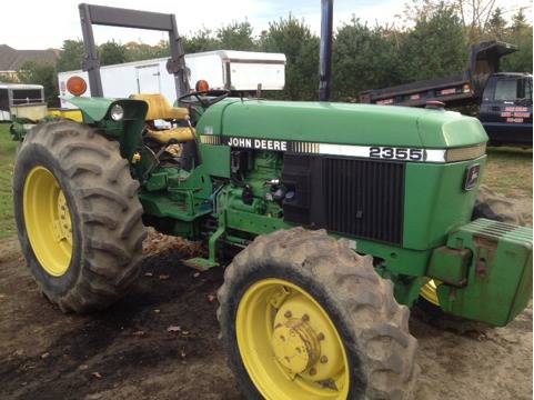

    The tractor in the photo, JD 2355 would make a nice choice. Add a loader & you will never regret it.

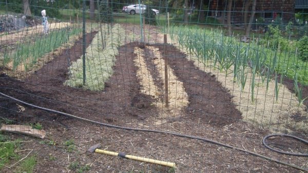

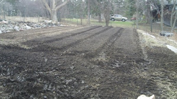

    I get around the compaction issue in the garden by maintaining established beds/walkways. Beds get another 20-25 yards of compost every year and the walkways get mulched after I prep the beds. Its been working pretty well and the garden gets better every year. The thing is the garden is only 10,000 sq ft and is terraced on three levels...not exactly discing material.
    My rototiller actually sits between the wheels of the tractor.

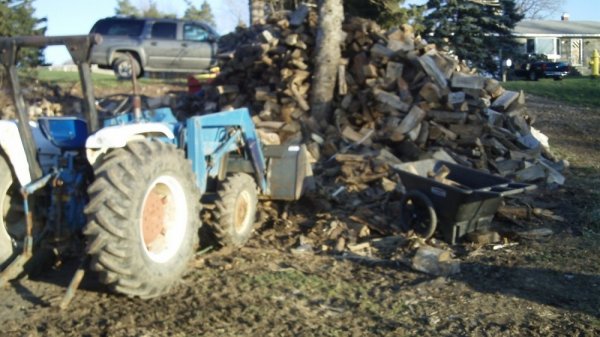

    Nice wood pile
    SolarandWood likes this.
