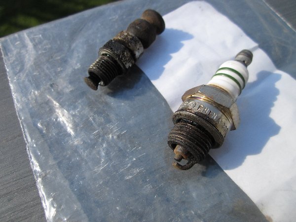

    I'm just kind of curious if anyone knows the cause?
    I had the one on my Stihl MS361 fail last week Friday and I replaced it Monday along with a new spark plug since I couldn't remember the last time I changed it. I had noticed it was getting a lot harder to start, and then Friday even just a partial pull would cause it to pop without a sputter from the engine. With the new valve and spark plug in place, It's a heck of a lot easier to start and runs like a champ.

    Most likely carbon buildup.
    My Mac SP125C starts much easier since I replaced the old points/condenser with electronic ignition module 2 years ago. Trying to start it without pushing that decompression button first will break the starter,your fingers or both..Havent checked in almost a year but compression after sitting a while was just under 200 PSI.
    However I have noticed that gradually over the past few months its starting to pop out pretty quickly also,barely half a pull & it'll snap your wrist. Until I get around to replacing that valve I just hold it in with 1 finger on left hand while pulling rope with my right.

    Yep, it could be carbon buildup from the looks of it.

    My 361 would "pop" the decomp on every pull whether the engine fired or not. I took it out, soaked it with carb cleaner, gave it a once-over with a wire brush and blew it out with compressed air, and it worked fine after that.
