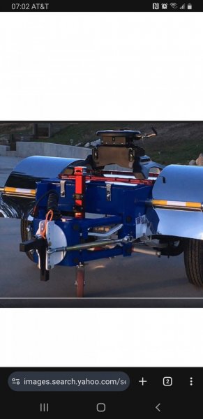

    There is a "dolly" that will attach to the ball of a bumper pull so a fifth wheel can be pulled on a bumper. Screenshot_20260208-070221_Chrome.jpg Screenshot_20260208-070221_Chrome.jpg

    Part of the problem is that 5th wheel trailers are usually big/heavy, too much to safely hang off the back of the truck frame, that's why the 5th wheel hitches are mounted an inch or two forward of the rear axle.
