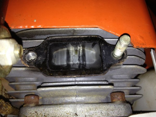

    Amen. You can do a lot with a saw that most "rational" folks would scorn you for even starting. I have two personal examples. I used to have an MS290 that I kept around for my loaner saw. If you pulled the muffler (really wish I had pics) you'd see a piston that was scored to absolute chit with significant damage well into the rings. It still made 140 psi, passed a p/v test, and ran like a champ. After loaning it out to a buddy he begged me to sell it to him. I showed him what was wrong with it and he still wanted the saw. I sold it to him cheap three years ago and he's still running it regularly as his firewood saw. He loves it and says it still runs like a champ.
    In 2013 I purchased my first 090 as a known scored saw. It made 150 psi and ran fine when I bought it, and I figured with the level of scoring and how it ran surely I'd be able to clean up the cylinder. When I got it home and pulled it apart I found not only a scored piston, but compromised plating in the cylinder. I posted (on AnotherSite) with some questions about running a scored saw if it ran well, had good compression, and passed a p/v test perfectly with zero leakdown. I got flamed for even thinking about running a scored saw, much less an 090. I quietly walked away from the 'conversation' and did what I always do . . . whatever the hell I wanted.
    I did a little cutting with it and then proceeded to take it to a GTG and pushed it hard through several tanks. Ran it hard all day . . . I had blisters on my hands and the tingling from my elbows down didn't stop for a full day!
    Here is a shot through the exhaust when I bought the saw. It made 150 psi and passed a p/v test:
    Here is a shot through the exhaust after the GTG. It made 150 psi and passed a p/v test:
