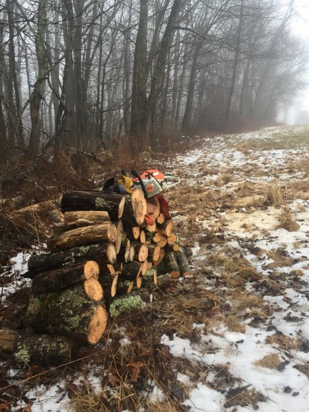

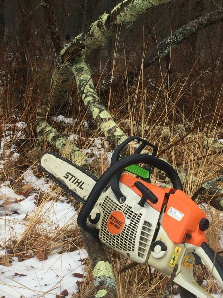

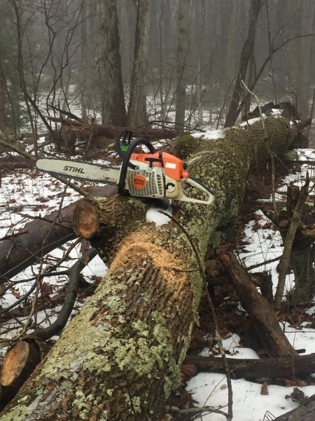

    I just finished a rebuild of a MS280 today.
    New piston and rings, new crank seals, new fuel line and filter and slight muffler mod.
    I’ve read a lot of posts on the saw and the one thing that comes up often is the AV is to flexible. And that causes a lot of intake boot rips.
    Mine has no H adjust on the carb, which wears a solenoid.
    I think it still needs a carb rebuild.
