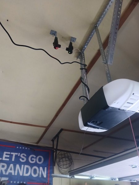

    I've seen the eyes mounted on the header about 2 feet apart. The door works much better that way.
