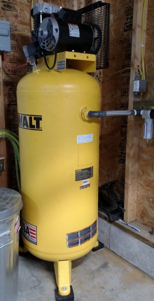

    I ended up offing my parts washer and use an 18 qt roaster over so I can heat the solution. I use that for cleaning up nasty old vintage saw parts after scraping off what I can. I upgraded my air compressor as well. Tractor supply had a sale on a DeWalt 60 gallon upright with piston pump that uses oil. It was under $400 before tax. Definitely was a huge upgrade over the old 20 gallon oil-less noisemaker.

    It has so far. Helps keep the pine pitch from sticking. Everything seems to come off easier. I put it on the entire exterior. Metal cases and all.

    That looks great! Imagine me running with only 7 gallons and try to blow anything clean. 12 seconds later and the pump kicks on.....and this is an oil lubricated one but still loud as all hell.
    I was going to go with the Husky C304H but then I read some commentary on how running 175psi on a 120v compressor was a recipe for an early death. And there's a reason it's the cheapest 20 gallon oil lubricated compressor with at least 5 scfm. So I'm still in the research mode. I don't need it for automatic sanding or cut off wheels......I just need to blow things dry and maybe once in a blue moon use it for nailing or spray painting (i.e. I used my old one to paint the truck bed liner onto the side steps of my Tacoma).
    Right now I'm spending $3.50 a can on brake cleaner which does not last long at all. I swear some of these cans last half as long as others. But it sure gets the job done and is convenient.

    Yes Brake Cleaner is probably not the cheapest option but I do agree about it being convenient and it works.
    I also have a Safety Kleen parts washer that I use for some jobs.
    Oil lube compressor is fine for what you will be using it for , I have had my 60 gallon for years and it just keeps going , check the oil once and a while and there is no reason it won't last.
    The only drawback might be spray painting and possible oil residue from it , if you are going to paint they make filters for the airline for that.

    Thank you. It was definitely one of my "why did I wait so long" type of upgrades.

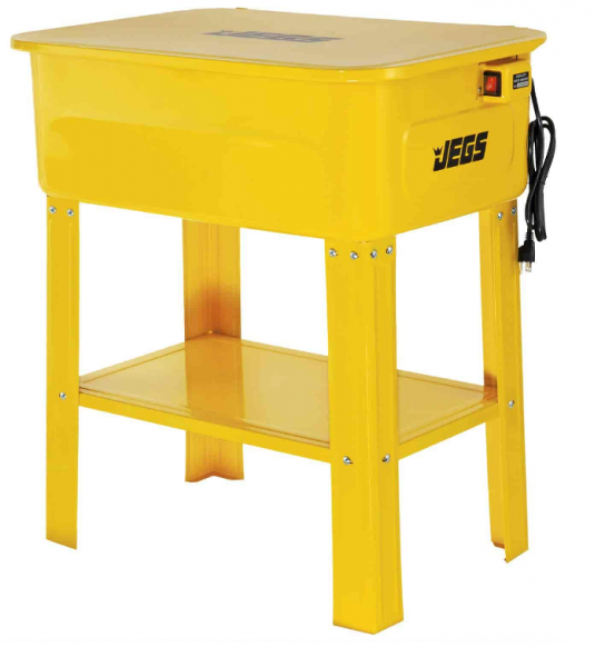

    Yeah I was thinking of using TSC's PSC1000 solvent. Read that that works really well. I was leaning toward's HarborFreight's 20 gallon parts washer but then it's not even on their website anymore. I think a similar one is the Jegs parts washer here:
    I don't need it to be too fancy and space is tight....but it's a good excuse to organize and get rid of crap I just don't need.
