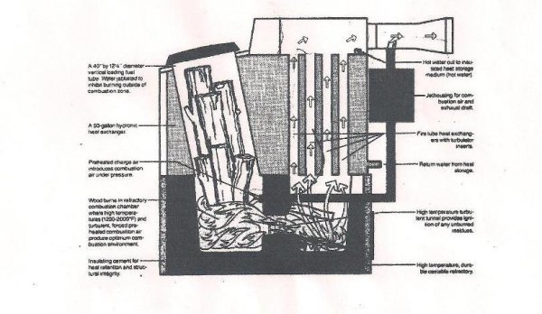

    For the old Jetstream pellets would be BAD news! The forced combustion air into the burn chamber is designed to burn only a measured amount of wood. The loading tube and burn chamber have a total height of 42" and a 12" diameter with only the bottom 16" of the burn chamber intended to burn wood and not the wood in the loading chamber portion that is surrounded by the water of the heat exchanger. I have set up the wood drying system so that the wood is under cover for over 2 years in the wood shed and achieves a moisture content of about 17% which is ideal moisture content for most gasification boiler. But 2 1/2 cords can be stored in the boiler room with a annual wood consumption of 4 1/2 cords per year and where the boiler room can reach temperatures of 110-120F during a 7 hour burn cycle, so most of the wood burnt is under 7%. Ideal split size would be 3 to 5 splits from a 12" round. With the really dry wood only 2 or 3 splits can be burned at a time as there is just not enough oxygen for complete combustion. With the super dried wood, boiler output remains the same but a lot less wood is burned to bring storage up to temperature. The problem that results from trying to burn a complete charge all the smoke that is generated cannot be burned efficiently and worst case scenario caused is puffing. The fire is momentarily extinguished for lack of oxygen and reignites with explosions of varying degrees.
    On the Jetstream, the cool water jacketed portion of the loaded tube quenches combustion in this area, but with super dry wood combustion does take place in the loading tube generating more smoke than can be burned cleanly because of fixed rate of combustion air, so the amount of fuel available for combustion has to be reduced.
