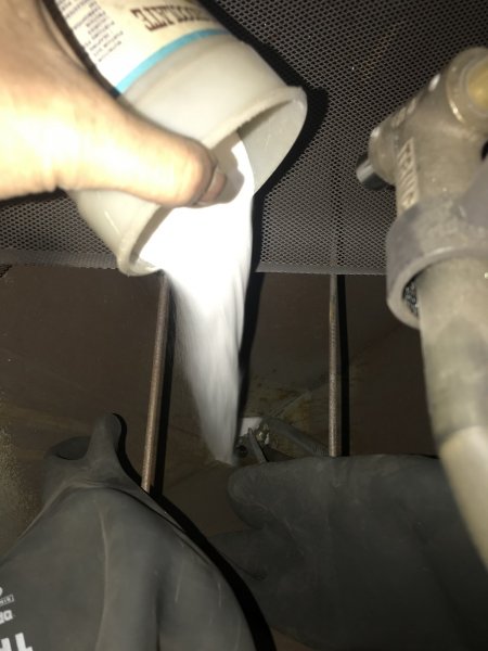

    Hello
    Just had a consultation on types of blast media, their aggressiveness and type of finish for cleaning black carbon and white calcium on dirty rusty parts (Burn pots, baffle plates and augers...etc) with different blast media and it’s re-usability!
    Which should I use for steel and which for cast irqon?
    I came up with 3
    1. Black Diamond from Tractor Supply
    Medium grit that is somewhat reusable. $8 50lb bag
    Semi rough finish but cheapest by far

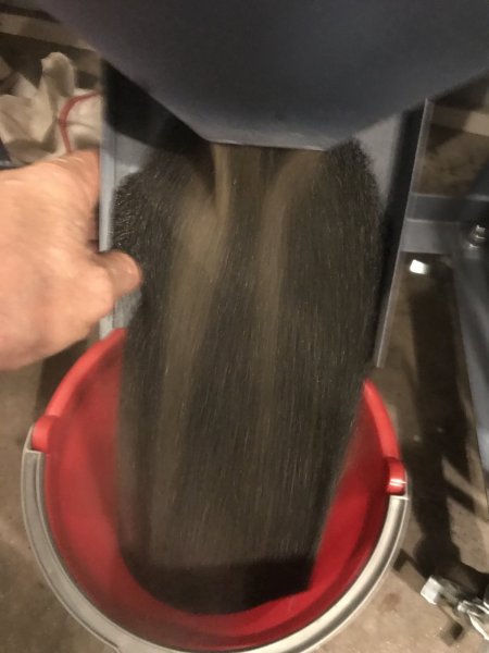

    2. Glass Beads from Kramer Ind. $70 for 50lb bag
    Medium / Fine grade and is re-usable
    Smoothest finish but less aggressive so more passes to get a clean finish.

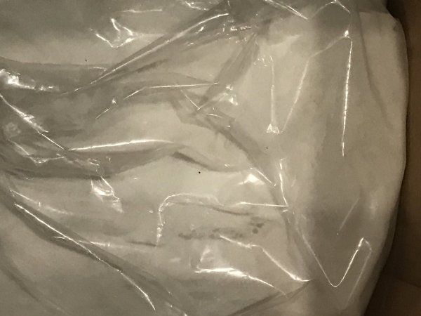

    3. White aluminum oxide
    90 Mesh
    Tougher finish but more aggressive so less blasting time to clean.
    See pics
    Pic 1 - Black Diamond also called Black Beauty made of coal slag
    Pic 2 - description of glass beads & white aluminum oxide
    Pic 3 to 5 - Glass beads 50 lbs

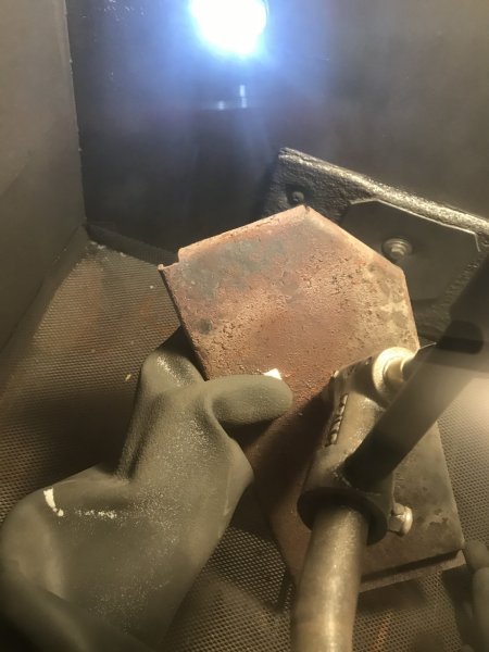

    Pic 6 to 8 - White Aluminum Oxide 50 lbs
    Here is one comparison between Black Diamond vs Glass Beads

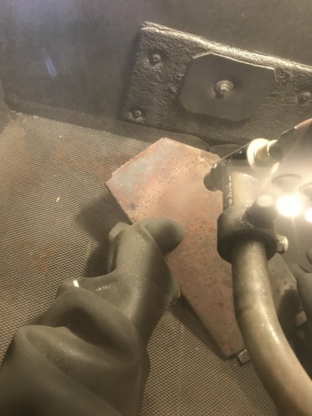

    Well now it is out with the Black Diamond Coal Slag and in with the more expensive$$ White aluminum Oxide!
    So far it seams the AO2 is better for this heavy rusted Quadrafire Top Baffle Plate! :)
    Thanks Everyone for all your Help!! :)
