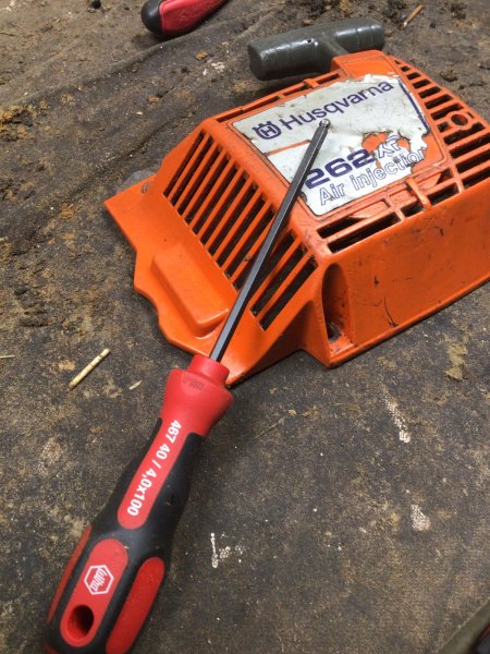

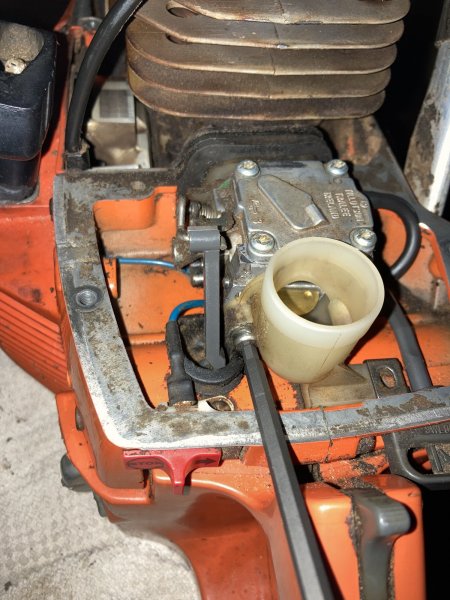

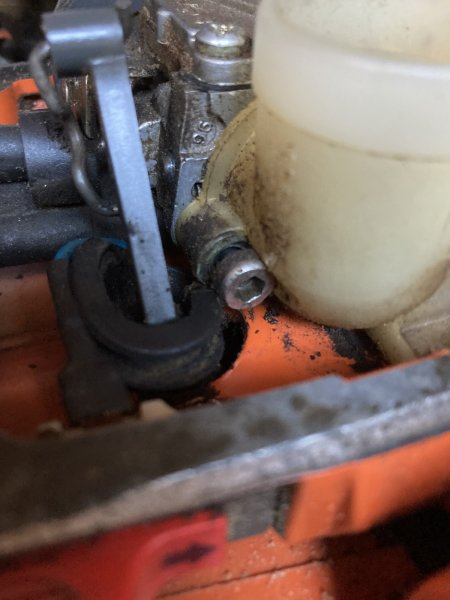

    Is there a specialty allen, or other trick to get the @&$%n bolt out without drilling a hole into the saw?
  2. Nixon
    Nixon
    669
    3,018
    West Sunbury,Pa .
    Ball driver .
    JB Sawman, metalcuttr, M2theB and 4 others like this.

    Thanks for the replies. I will see if I can pick one up tonight. Struggled with a cut down Allen making a 1,000 .25 turns to get off. The carb screen was chock full of fines. This is my 272 that wouldn’t run right.

    The carb screen packed with fines led me to the tank to find the end of the fuel line had split and dropped the filter, so the bottom of the tank got vacuumed out.
    Went to Home Depot and of course I had to buy a set of ball drivers to get the one I need.

    All back together. This tool would have prevented a headache. The wife is gonna be pizzed when she gets home and the house smells like gas. :rofl: :lol: Did my mechanicin in the comforts of the living room.

    Word of caution . Don’t get all crazy torquing things down with that ball driver . They tend to snap off right at the ball when they fail . If you are lucky , the ball part will stay in the fastener so you can get it with a magnet . If you are like me , you get to disassemble the saw looking for that little gem . And , it’s harder to do now that you broke your ball driver and have to use at cut down allen wrench to disassemble the saw . :thumbs:

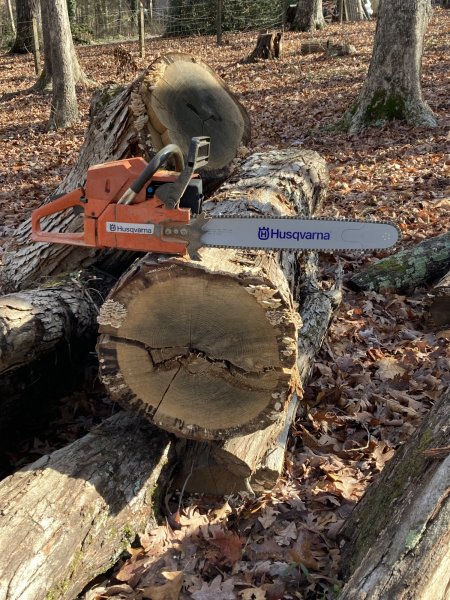

    The saw fired up fairly easy this morning, so I’ll put it in some wood later today and report back.
  20. Chud
    Chud
    Aug 15, 2020
    6,776
    49,213
    NC
    Fresh bar good to go. Cuts and runs like it’s old self.
