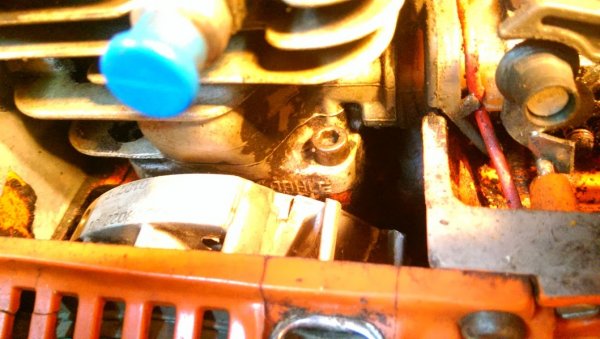

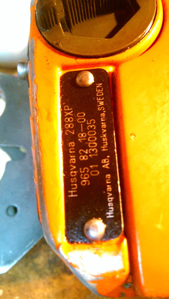

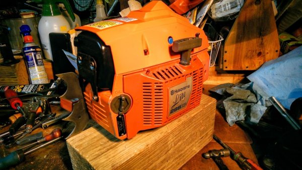

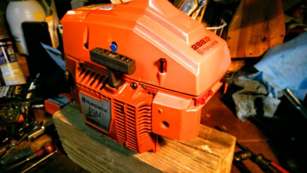

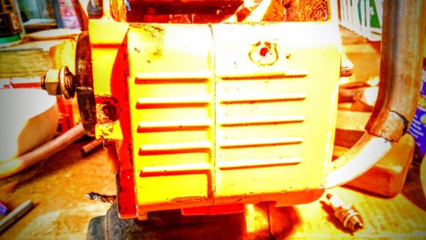

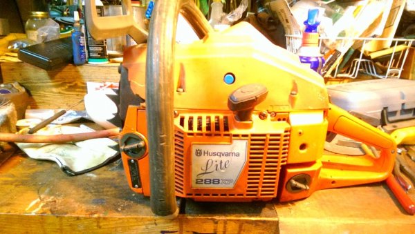

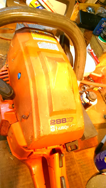

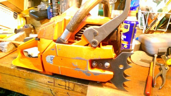

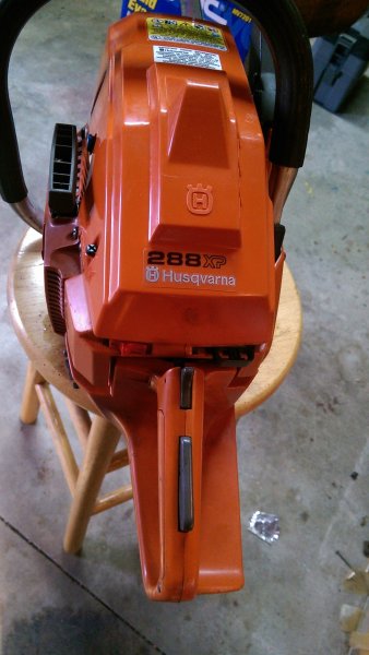

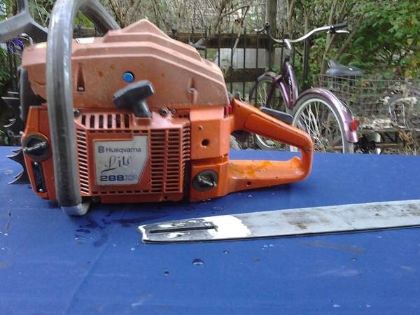

    It was a rain day, so no firewood cutting. Saw an ad on CL for some Husky Rancher 55's, but this 288xp came home with me.

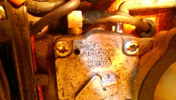

    It's going to need some parts and a good cleaning. It has spark and decent compression. From what I can tell from the exhaust port, the piston & cylinder look pretty good.

    Nice find! I'm betting that should have some serious grunt when it is running.

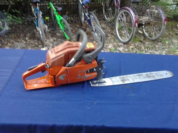

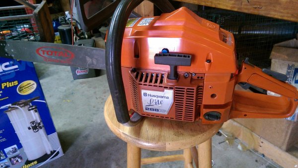

    I talked with him on Thursday and could not get straight answers on the condition of the saw. While the price was enticing, I elected to not make the 2 hour round trip to check it out. If it had come with a bigger bar I may have been swayed to take a look.
    Glad you got it and good luck getting it going, here are the pictures from the ad that I saved.

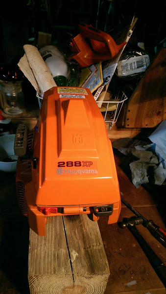

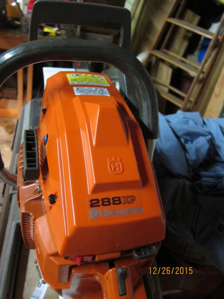

    Did a little work on the 288xp. New top cover, Meteor piston & MM cylinder clean-up, bearings & seals, Carb kit, muffler, oil pump, fuel line/filter, trottle spring, chain tensioner & a-v mounts.
    Now for some work on the handle/tank to clean things up a bit, a 28" b&C and we should be good to go. 288a.jpg 288b.jpg 288c.jpg 288e.jpg

    Soon, I hope. I left off the base gasket and it's running .020 squish, it has a ton of compression. I'll have to post up some compression #'s before start-up.

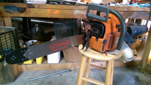

    Did a little more work today. Installed the anti-vibe mounts, fuel line, installed some carb parts I left out. Didn't get a chance to check the compression, I wanted to hear it run.
    Still need to paint and install the decal on the clutch cover and find a good 28" bar & chain.
    Here's a quick video from my phone and some pics.

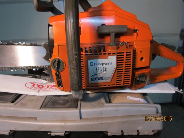

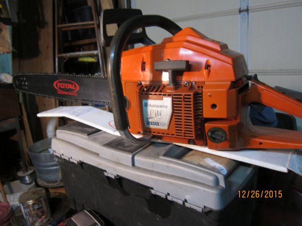

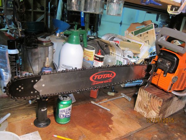

    The 28" bar arrived today from fordf150 . The 288 is complete. Next week we'll get it dirty in some Osage.
