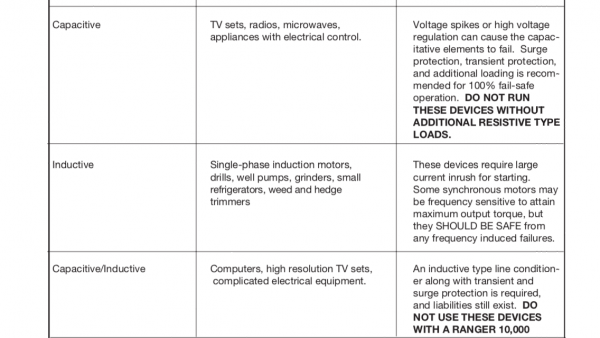

    Miller does claim to produce clean power however to Lincoln says not to run computers on their generators.

    "Great info here"!!! Nice read out on the manual. :yes:
