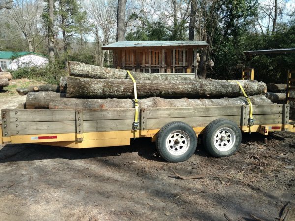

    It really depends on the trailer. We hauled logs for 11 years on our 16' flat equipment trailer. With the length and axle placement, it is easy to adjust tongue weight with log placement. IMG_20180223_125553962.jpg

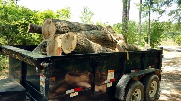

    After we got the dump trailer in '18, things changed. Axles are at the back of the trailer. This load.... IMG_20190603_131314500_HDR.jpg

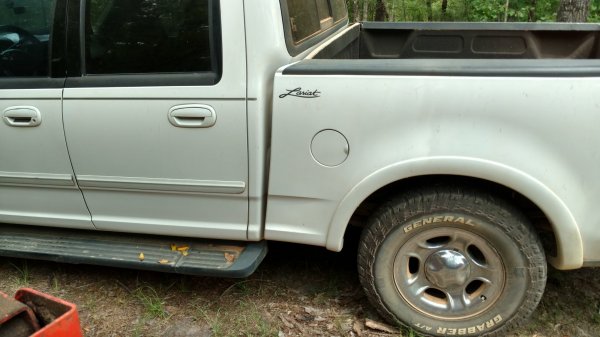

    Bent the chassis. Got that straightened and reinforced.

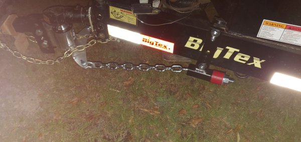

    Did my research, the Andersen Hitch had the best reviews, yes, it's $$$, but well with it. Easy to hookup and adjust 0523202113.jpg
    It is a distribution and anti-sway hitch together.
    Andersen Mfg 3350 No Sway Weight...

    So to load it you have to tighten the nuts by the red part? I'm kind of having trouble seeing how it will transfer the load...guess it does it by tension. It was a hard thing to think through in my head how a normal bar setup takes load off the vehicle.

    The chains take place of the torsion bars on a regular type hitch. The chains are usually set before you load. They attach to a boomerang shaped wing on the bottom of the truck hitch.

    That's what's hard for me to understand. A normal hitch has Ridgid bars that attach to it and based upon the pressure you load them it transfers the load from vehicle to trailer. With out the chain being Ridgid it is kind of mind confusing. But I guess you tighten the chain so much that it pulls them tight and transfers the load back to the trailer like a torsion bar kind of? Tighten a tortion bar and it lifts the front of said vehicle and also stiffens the ride.

    That's to right thinking. The chains are set/ adjusted before you load. Just like a regular hitch. You hook trailer to ball, then jack tongue back up to hook bars or on this hitch, put plate with chains on stem at the bottom of the hitch. I need some better pics of it. I may try to do a video maybe Monday or Tuesday. Got to haul a load of wood.
