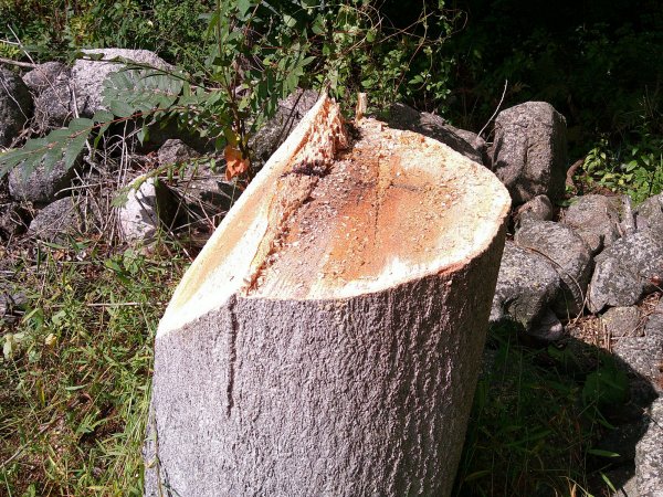

    I don't fell trees that often. I use the Humbolt notch. Im thinking this keeps the tree butt from going backwards as it falls. Plus the bottom log doesn't have the notch in it either. Pic of TOH stump I felled last week. DSCF0063.JPG

  9. buZZsaw BRAD
    32,189
    195,854
    Very true. Lose the hinge and center of the trees gravity takes over. I've lost some by over cutting the hinge:emb:. Patience is key when making the back cut.
