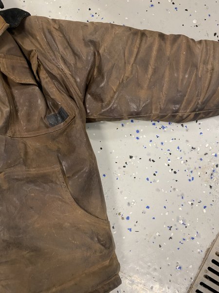

    Evening all and a Merry Christmas!
    We run a wood boiler and burn a lot of wood, so I need to go out and fill it before bed each night throughout the winter. I was getting filthy and often smelt hard of smoke etc. when I came back to the house, let alone it being -21c with the windchill here in SW, Ontario Canada right now. I needed to up my outdoor gear game! Funds are tight, and I’d ruin good stuff with soot, burn holes etc. so I bought cheaper canvas items and waxed them. Waxing canvas makes the material much more durable against tears, wear, water and most notably, wind. I followed the ingredients in this YouTube video below, but there are others out there I’m sure.
    I’m really happy with the results, I thought that other people might be if it from it too. They have made great chore, hunting and boiler filling overalls basically. Anybody else work with waxed canvas for firewood orientated tasks? Cheers!

    Indeed, I’m sure they’d wash, although most brands recommend against it. Just reapply a topup, wax/oil. Dirt just brushes off basically, but haven’t worn them long enough to leave my scent inside them lol, plus usually only wear them for 15-20 minutes at a time.

    It’s been a long time. I believe it was gulf wax and paint thinner. Couldn’t tell ya what quantities now though.

    You can use beeswax. My wife used beeswax and cotton fabric to make all natural reusable cling wrap alternatives. Like these:

    I don’t know, try the beeswax and let us know! I’d like my mixture to be abit more ‘oily’ maybe the beeswax will offer that?
