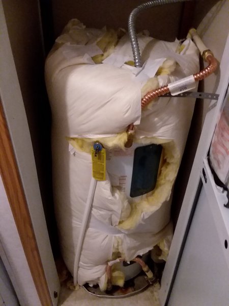

    I'm thinking about replacing this myself. Anyone with plumbing experience- I found one that is 240v, but it says I need a double pole 30 amp circuit. I have a dbl one in the breaker box, but they are both 25. Will these need upgrading?
    I'm also hoping to find something that has the side plumbing.
    I'm hoping the problem doesn't get much worse for another week when I have a day to deal with this! Uggg

    Yes definitely use the size breaker they are calling for. Also something for you to consider is that the wire may need to be upgraded as well. Typically a 30 amp water heater now requires 10 gauge or sometimes even 8 gauge wire.

    I am guessing that is a manufactured home ????
    If it is the water heaters used in them have different ratings, must be rated for manufactured home use.
    I have not seen a side plumbed WH.
    Looks pretty tight in there good luck.

    Yes it is. The water heaters I'm looking at online are manufactured home approved. They are all top plumbed though. The only thing I'll have to change is getting a longer inlet pipe.
    Yes, it's tight and will probably suck being in a small closet. Uggg!

    How tough is it gonna be to get that insulation jacket off? Need to check for secondary leaks.

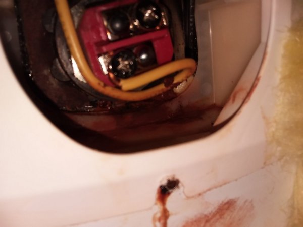

    Not hard, I think your right. Upper element gasket. Will switch it out tomorrow! :thumbs:

    Gonna just replace the upper element- it seems the gasket is what's leaking. Heater is 13 years old. Might get another few years outta it.

  10. Well Seasoned
    83,785
    The leak......

    Hopefully this isn't one of those "one leak repair leads to the next" situations...many times once they are old enough to start leaking, fixing them is an uphill battle...hope this is the exception though! :yes:

    $16 bucks worth a try, but your right. I'll plug one hole and another will appear. o_O

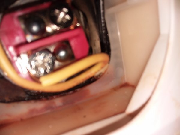

    Well, I picked up another heating element. The leak appeared to be right around the gasketed area where the heating element screws in, but unfortunately the leak is just below that.
    It's a small leak, but we don't want to wait to long- just long enough to decide on another water tank or a tankless system, which I can get a good one for a decent price. We'll see-
