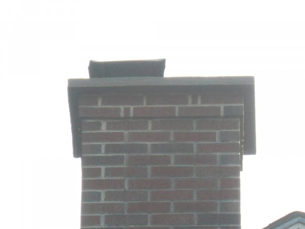

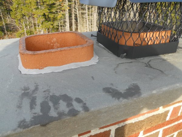

  16. DaveGunter
    DaveGunter
    3,894
    22,934
    Here are some pics of the top of the chimney. I'm thinking this top piece of stone is nothing special as I can see what looks to be similar on a few different chimneys on the way in to work today. I'm gonna get in a freakin wreck being a chimney voyeur.:picard:
    I forgot to measure the outside of the stone when I was up there:picard:, but its 19.5" from the outside of one clay liner to the outside of the other. I had to bend the roof of the cap that is now on the wood stove flue so it wouldn't dump water down the furnace flue.
    basod and Eric VW like this.
