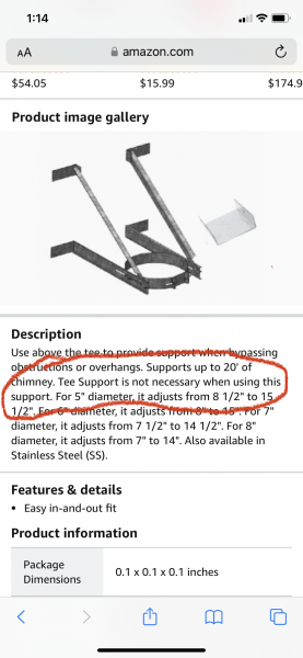

  11. Eric VW
    24,154
    138,458
    Looks like the link says it can be substituted for the support?

    Eric VW I was looking at the adjustable brackets myself and it was just a little shy of what I needed, I needed 17 ¹/²" off of my house.
