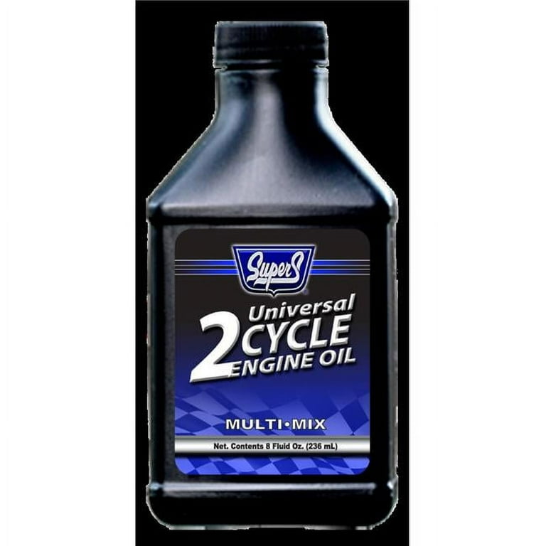

    Do you have any experience with this stuff?
    I came across it at Dollar General recently and bought a couple small bottles to try out. Figured if it's not up to snuff I could still use it in my weed whacker, maybe...

    I haven't.
