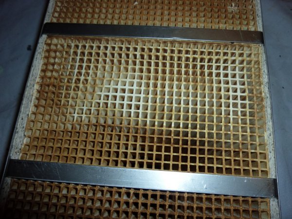

    What didn't you like about the new one? This is what I saw when I got an AC cat for the 91 a couple years ago. I thought the cat coating looked a bit sparse but it's been working fine. I kept the one that came with the stove for a backup. It looked good but I was unsure about how long it had been in there. Being new to the stove, I didn't realize until later that you can't rush the light-off, stove innards have to be up to temp. It would be great to be able to get a DuraFoil steelie for the 91...maybe soon.

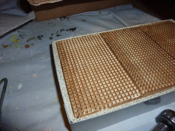

    Coating looked fine but the insulation on the one end of the can was not full so would have let smoke/air through without going through the cat and a small corner was chipped off one section.

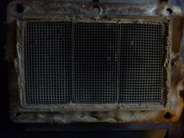

    I thought the same thing about the straps being down but I just really don't think I remember them being down when I had taken a small artist brush a few times and brushed the fly ash off the bottom of the cat through the screen. BUT I'm not sure.

    Here's the original, before I simmered it out in the distilled water/white vinegar. Looked real good after that, no cracks or loss to speak of.

    I checked today, and had the straps down but I can't remember if the old one was like that. The above pic was the first time I took it off...maybe. :confused:

  18. Locust Post
    8,792
    50,935
    new one arrived today and it looks better.......I'll get the stove back together sometime soon then I'll be gooder to go for burn season......stove is all cleaned out with a can of damp rid sitting inside, I ran a brush down the chimney but got virtually nothing out of the chimney and only a few flakes off the cap. Have I said how much I like this cat stove, of course 3+ year old wood contributes to the outcome as is well known.
