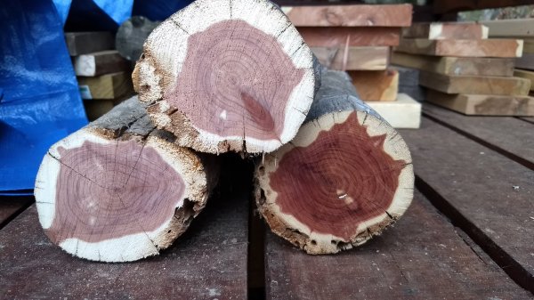

I found a lot on Western Red Cedar but nothing on ERC. Its a different tree. Very dry and gets very hard when older. I've used it a lot around here and it burns very hot. My question is how big a log or split can i put in a stove without overheating it? Some of the wood i have is 6 to 9 on the moisture meter, the bark was peeled before storage about 5 or 6 years ago.

Hi billb3, 9i just checked on the actual height of the fire box. That really is low. It looked a lot bigger. do you think 5" diameter or split side is too big? I may have to split smaller. The big old open fire place i used to have took anything you threw at it, this is so different.

You'll want some big ones. I just split and don't worry about size. When I used to split by hand I'd start off kinda small but by noontime the split size were kinda large, as in good enough, gotta get this done. 5 or 6 inches isn't too big for sure. I've slid some slabs in that were as wide as the door. The problem with 7 or 8 inch square splits is trying to get three or four or more of them in. A 14 inch log split in two works but anything bigger I tend to split 4 ways. Anything bigger exclusively won't work - so you need some smaller ones to go along with fatties. . All small ones don't seem to last as long, but it might burn a bit hotter. Mine are mostly 5 and 6 inches with a few bigger ones 8/9/10 and my smallest ones are about 4. All the same size might look good in the stack but in JAn/Feb I tend to fill the burn box a little tighter.
billb3 you are a jem Nobody has that info posted. True North doesn't publish the size of the fire box besides a generic 2 cu ft. they tell the max length but nothing about width or height of the firebox. Looks like i'll be ok on most of the rounds but will have to split a bit smaller on some. That helps me soooo much Just picked up the chimney parts. we are getting closer

Thanks Kimberly, billb3 helped me straighten this out. He has a TN19 which is basically the same stove the TN 20 is the newer model (not always a good thing). The tn 20 has an ever so slightly larger firebox according to the manufacturer. However the only thing they let you know is the max length of 18" on the wood, no height or width of the fire box. As a result of not being able to find that out i split some of the wood too big but not as badly as i thought. This is a wonderful forum.
