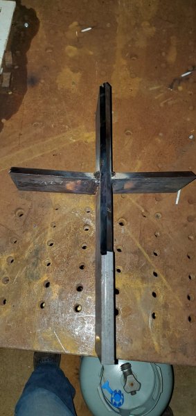

    After my failed attempt of my first edition conversion, we are giving it another go. This time, since I had to buy steel, I am going with the hydraulic adjustable wedge. Here were the results of the expensive, free steel, that I used. Wedge was way too soft of material.
    Pic of carnage of first splitter beam.
    Thr 4-way wedge is going to be a hydraulic adjustable this time.
    I'll keep updating as I go.
