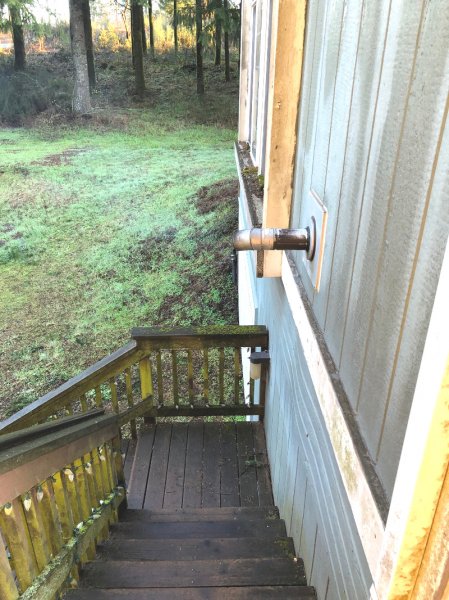

  5. Snowy Rivers
    Snowy Rivers
    Nov 15, 2015
    2,834
    12,423
    Newberg, Oregon
    If I remember correctly you need the end of your vent to be a minimum of 12" beyond the wall.
    Here is a pic of one of my stoves.
    I used a 45 elbow to direct the flow down.
    The pipe was a 24" long piece and I just adjusted the position so the stove was where I wanted it and left the rest alone.
    ttdberg likes this.
