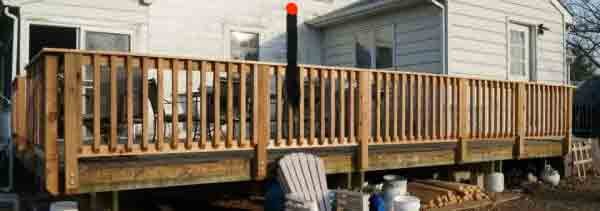

  12. Smokinpiney
    Smokinpiney
    3,811
    20,652
    "South" Jersey
    Here's an outside pic. Sorry it ain't a great pic but gives you an idea.The pipe would be exiting to the right of the window in the center of the deck and going just up past the eve on the right. There is an attic window above to the right but it doesn't open.
    Bob, have you ordered from unbeatable sales before? Definitely good prices but it's an odd website.
    wildwest likes this.
  13. Spock
    Spock
    Oct 15, 2014
    263
    872
    MA
    Dex and imacman got you covered on the up and out , out and up solutions so I will offer my thoughts about going up and through the roof. It will be a bit more work and expense. The venting still needs to be secured to the interior wall and a framed box in the joists is required. Obviously you have to cut a hole in the ceiling and roof. Most of the additional cost will be for a Ceiling Support Box and Roof Cone (assuming you have access to tools). Take note of where the ceiling joists are as they my dictate the stove location if you go strait up. But cleanest looking solution IMO and minimal joints are bonuses. A con may be that you have to get on the roof to brush the venting.

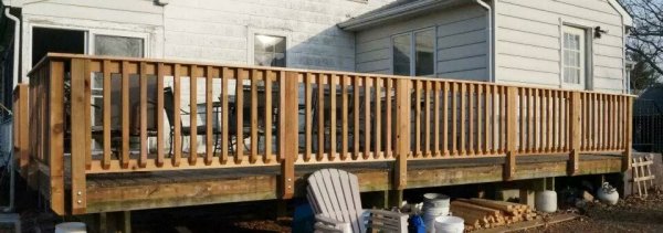

  14. Smokinpiney
    Smokinpiney
    3,811
    20,652
    "South" Jersey
    Here's a pic with a sweet photoshopped pipe added. Thinking about a 90 with termination cap where the orange dot is. The eve to the right of the pipe is not vented.
    Thanks spock, is roof venting a pellet stove not ideal? Or do most folks just go up and out/out and up because of the ease of install?
    Spock and wildwest like this.
  15. Spock
    Spock
    Oct 15, 2014
    263
    872
    MA
    Depends on your options. Looks, cleaning and ease of install fall into consideration while passing code requirements. In my situation the best solution was to go out through the roof, didn't want the vent sticking out the front of the house and had no other option for stove placement.
