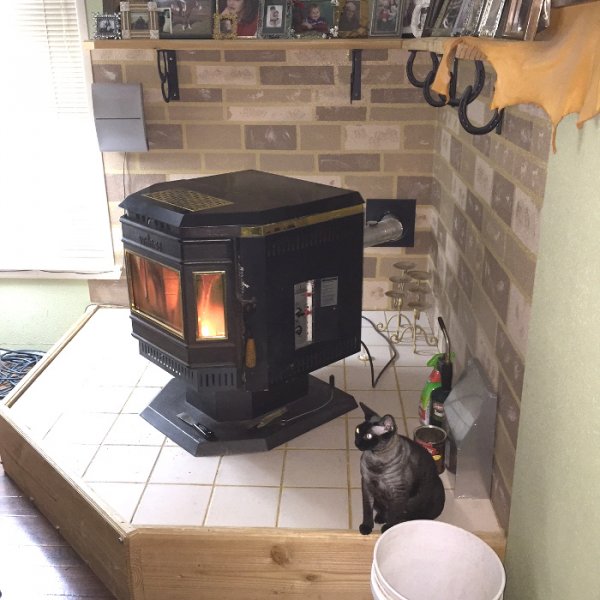

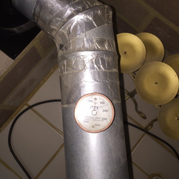

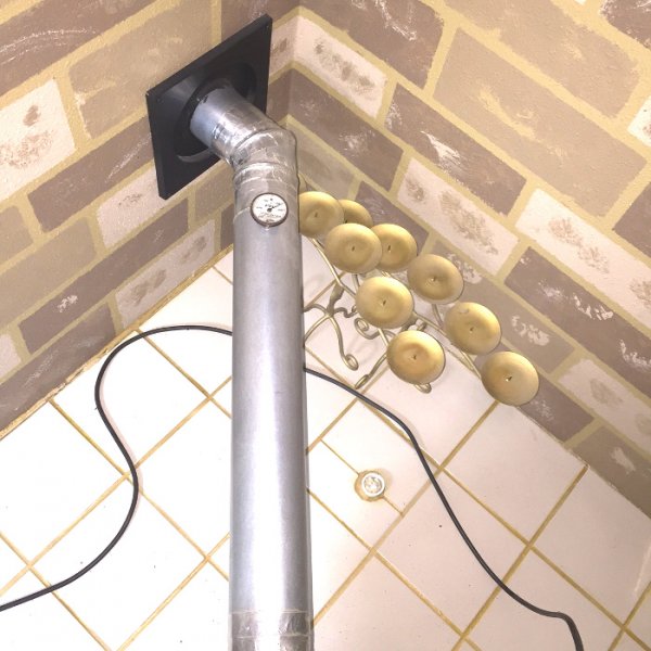

    I have nearly a 4 foot horizontal run on the big Whit (Needed that to get the stove where it would be centered on the raised hearth and have the vent thimble pass between studs, AND the terminus be far enough away from the closest window)
    I have stuck the thermometer in various places along the run, from right at the connection to the stoves exhaust housing, all the way out to the one 45 in the run at the thimble.
    The temp does not vary much along the pipe.
    Since doing a real deeeeeeep cleaning the other day the temp dropped to 130 F instead of 140-150 F
    That has got to be due to better/faster air flow through the pip
    Here are some pix of the setup
    The little Fur Child was there to help too
