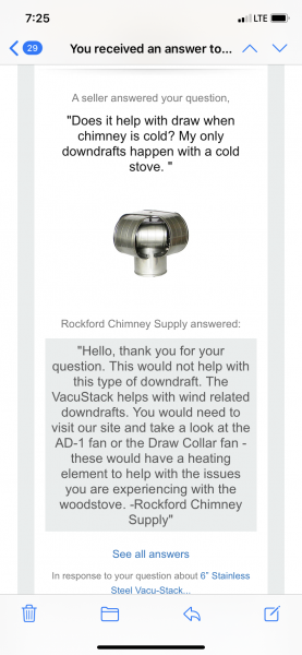

  20. Slocum
    Slocum
    Mar 30, 2018
    1,363
    10,488
    North Central Indiana
    BF8C9DAD-AB04-466F-A1BB-264E943DEAC4.png That sums it up for me.
