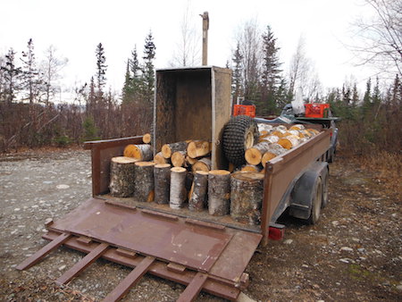

  13. bogydave
    IMO
    For a trailer you want strong & tough
    Steel frame will take many years to rust,
    & with a little TLC will last a lifetime
    I vote :
    STEEL
