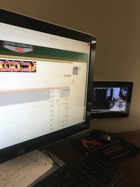

    2888421D-3E46-46D2-AD1C-4AD55CDA79EE.jpeg E876F149-51EB-4B62-A73C-9F2597FCF276.jpeg 9BC4D6E5-E184-42A3-A093-03A7ACAED96D.jpeg I’ll burn when I am away from home. It’s not a must here in the Mid East or “south” as some call it and I do have a new stove but for all intensive purposes, there is a fire in my basement right? My chimney is 40 years old and is clay lined. It has a witches bend and the clay doesn’t look at good as it should but I have a well built and huge chimney. Still, for me, it’s always on my mind.
    So with all that, I decided to try to use some modern technology to help me keep an eye on things while at the office. I’m literally 90 seconds from work and can get here fast but I still wanted to keep an eye on things.
    Years ago, I installed 6 1080p cameras. They are nice and I can see everything from work on an iPad that’s on the wall beside my computer. It’s real time and clear as a bell.
    So as far as my stove, I felt “green” running it this year. It’s finicky and sometimes the temps jump all over the place. I am better at it now though.

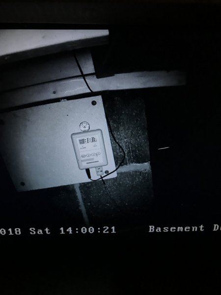

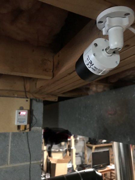

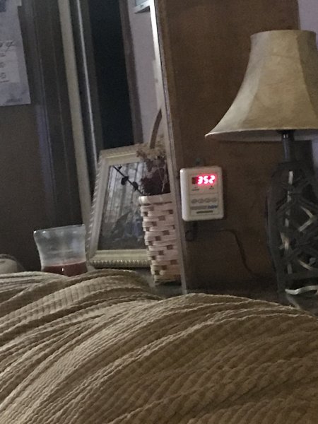

    I purchased an auber instruments pipe temp gauge and slave unit to go with it. The main unit is in the basement mounted to my chimney and has a temp wire hooked to the pipe. The slave is upstairs in the bedroom and reads the same temp and the main unit. I even have the app on my phone so I can check it anywhere. IE: last night at a high school ball game.
    So all I did was take one of the 2 cameras in my basement and pointed it towards the main unit at the chimney. Now I can see in real time what my pipe temps are and when it’s time to come home and re load.
    I work for myself so I am lucky that I can leave the office when I need to. Here’s a few snaps of the setup. Call me paranoid and I may be but it does ease my mind while gone.
