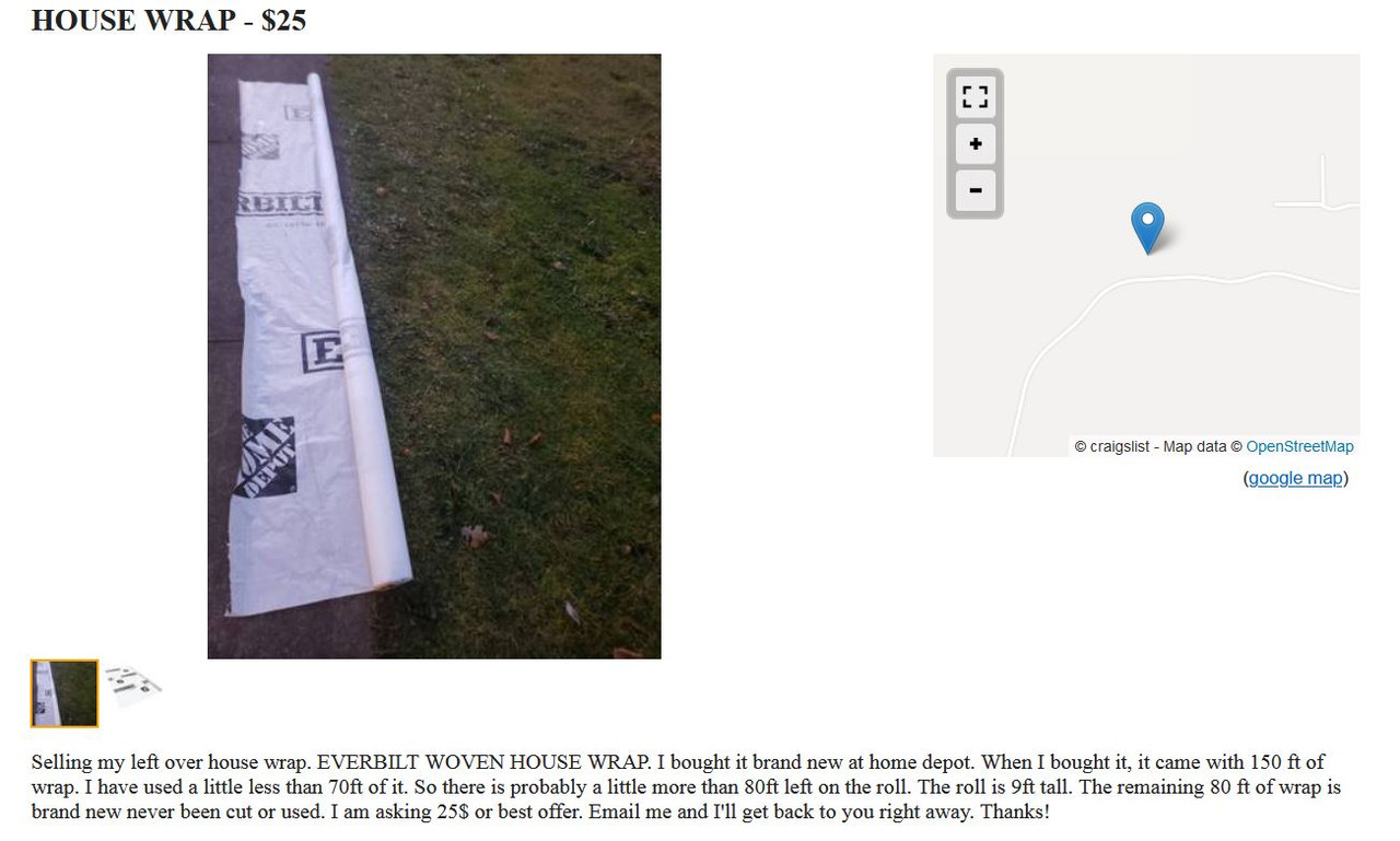

    Hi everybody!
    Wouldn't using house wrap as a top cover for stacks allow water vapor out and keep water drops from coming in? What do you think?
    I searched - didn't find this as a topic, and I sense that a lot of us are using some nice weather to get started on 2025 and beyond. Price is right on leftover on roll.
    Buzz

    7 years out of a product that's not meant for weather exposure, I'd say you're doing pretty good.
    To the op, for $25 give it a try. Keeping it on in the wind might be challenging. Like Camber said, lots of staples.

    house wrap can come in sizer from 8 to 12 foot. I am framing a 10 foot garage right now, and ordered it 12 foot to cover the energy heels on the trusses. If I'm on a step down foundation, I'll just cut the whole role on the chop saw to desired length. I probably have enough to cover a super walmart right now. It is loud and obnoxious if not stapled down properly. If you have hoarded enough wood not to have to play with it, then it will work more than fine for the OP. I bet he could get it free if he went by a few jobs with a good attitude. Shoot, I'd give him enough to cover 30 cord for free. If you do not use Tyvek brand but instead find some woven nylon type of housewrap and staple it down properly with a hammer tacker, it'll last over three years up here. Maybe not in Arizona, but it worked in South Carolina, and I know it worked near Hobart WA just fine.
