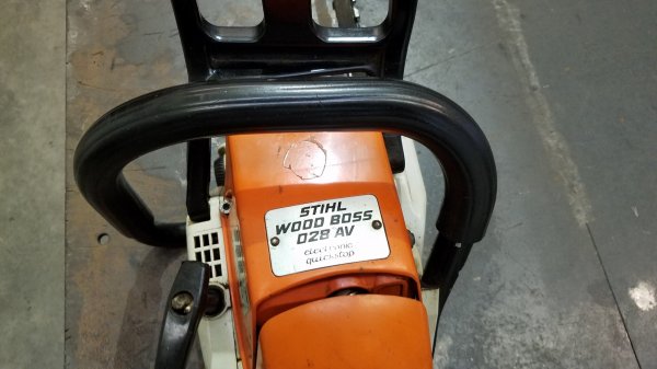

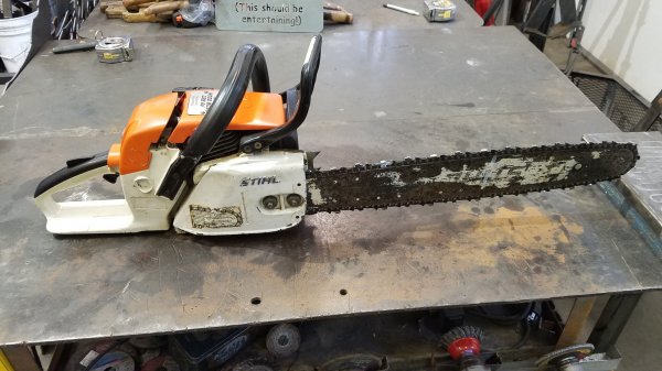

    Went by a garage sale yesterday and saw this 028 saw. Guy said it had sat in the shed for several years and he could not get it to start. He said he had tried every conceivable adjustment on the four adjustment screws to the carb but no luck. It turned over well and had good compression so long story short I got it for $30. I figured I could unload it for parts for that much. I rushed home and cleaned the air filter and poured out and replaced the old gas. Spark and plug looked fine so I preset the high and low jets on the carb and the idle screw from the on line manual. The manual said only 3 adjustment screws. Where was the fourth that the guy was talking about? I noticed there was a funny looking screw on the left side of the saw near the carb that looked like an adjustment screw but was actually a bushing bolt for the anti vibe system. It was backed out a ways so I tightened it. I can't help but believe that he thought it was a carb mixture screw! Almost fooled Me. Bar wear surfaces are better than the paint wear would lead you to believe and it had a new chain. There is a tiny bit of bar oil dripping after running but that stops quickly. Is there an oil adjustment on the 028? I could not find any info in the manual online. I guess I will turn this over on Craig's List. Don't need to make a killing but am curious about a fair price? Thanks for any input.

    Yup. Fresh gas and cleaned the air filter which was terrible dirty. The high and low mixture screws were way off as was the idle. I did the preset adjustments and it runs like a champ. Just had to readjust the idle. I cleaned it up a little and sharpened the chain. Apparently the lines are ok as it runs with no problems.
