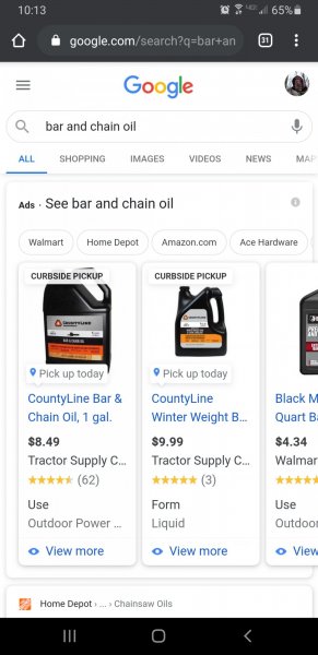

    Tractor Supply has it for 8.49 a gallon. I will have to stock up. Screenshot_20201115-221312_Chrome.jpg
  7. Mag Craft
    Mag Craft
    Dec 15, 2014
    4,802
    27,727
    South East Wyoming
    I have seen saws that had used oil from cars and such. I does eventually cause premature wear on the oil pump.
    Husky Man, mat60, Ron T and 3 others like this.
  8. JustWood
    JustWood Guest
    No go. Hydro isn’t really a surface friction type lube oil. As mentioned bar will fail fast. Put some in a soap or ketchup bottle and use it as fire starter. Pretty high volatility as far as oil goes . Not like gas ,,, but a little gets things going good.
  9. The Wood Wolverine
    17,587
    110,764
    Watch for it to go on sale. Usually about 2 for $14-15 at my local one.
