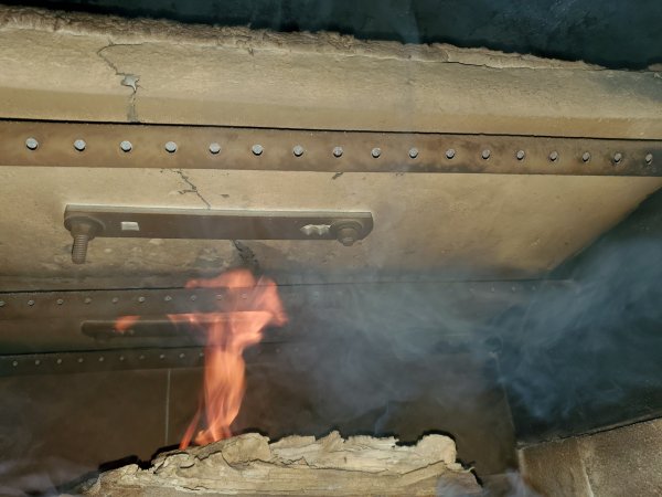

    Well I took all the brick and baffles out and the stove appears to be in very good condition other than both baffles are cracked in half. So as a temporary solution I took some flat iron and sandwiched the baffle between 2 pieces. (see attached) 20211210_093618.jpg The stove is functioning very well.
    Thanks again for steering me to the right conclusion

    Looks like that will work for now...just FYI you can just glue that cracked baffle back together with furnace cement...and it works well on cracked firebrick too.

    Never thought about gluing them back together..my only concern with the way I did it, is that the steel may begin to warp?? ..if it does I may pull it apart and try the furnace cement..thanks for the advice!..This stove was on FM for 6 weeks or so..pictures were poor and I finally ask for a picture of the nameplate..was tickled when I saw HT-2000..it took a couple of days before we could meet up so I thought I better seek some advise and I couldn't think of a better spot than FHC..been lurking on here for 5-6 months..that is how I decided on the IS..without FHC I don't think I would have ever spent that kind of money on a stove..been some of the best money I ever spent!..A little history..early 80's I heated my house and shop with wood..did so for the next 20 years or so..kids grew up so I lost all my help..Built a Corn Burning boiler that I have used for the last 15 years??..heated the house and shop with about 300 bushel a year..This summer I knew corn wasn't going to come back down, so I bite the bullet and bought the IS..a new 37T splitter and was lucky enough to find enough aged ash to get buy this year, and found more than enough wood that we c/s/s for at least the next 2..God has been good to us!! and so has FHC!
