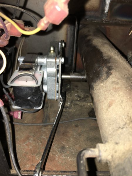

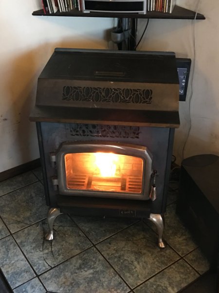

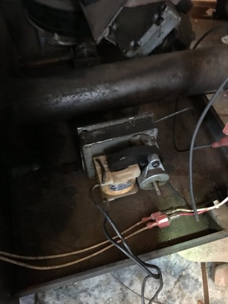

    Hello
    The old motor was noisy and starting to poop out.
    At first it looks easy to get at after opening the right side. However the 4 bolts to remove are on the inside along with the small set screw. A 5/15" ratchet head wrench works well for the bolts but the coupler set screw needed some help by wire brushing the corrosion and PB Blaster to free it some what. Then a vise grip on the Allen wrench with a hard twist and crack it did loosen! Then a few more turns and the motor pulled right out after unclipping the 2 power wires.
    See pics
    Anyone else do this??
    Pic 1 - old motor
    Pic 2-3 new motor with Zerk grease fitting and offset magnet
    Pic 4-5 Prescott EXL
    ivanhoe and BHags like this.

    I wish St Croix would upgrade their set screws on the versa motor coupler! It was tough to loosen them!

    I like the ideal of adding a grease fitting but it gotta come out somewhere? The only place it would come out is at the seal of the shaft. Maybe place the grease fitting below with a tiny vent hole near the top?
