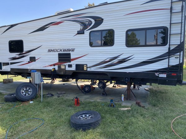

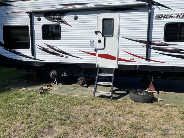

    So back at the end of August we purchased a new to us camper. 2018 forest river 30’ shockwave toy hauler. E6B6C2E4-6C6F-4C68-BAEE-1FD81AC49AEC.jpeg We really like it so far, but I hate pulling it. It’s set up for boondocking, with solar panel and a built in generator. Even has a fuel station for filling up the ATVs ( not that I’ll probably ever use that feature). Also the axles have been “flipped” to give about 6 inches of extra clearance for back country trails and roads.
    In an effort to reduce the white knuckle driving I’ve decided to put the axles back on top of the springs. Hopefully it will catch a little less wind and the lowered center of gravity will make it tow better. I realize it’s never going to pull as good as a fifth wheel but anything has got to help. Bought a new set of 5 tires with a higher load rating ( F)
    They seem to be stiffer and damm sure heavier. Probably 15 pounds heavier each.
    Going on a bit of a trip next week, not sure where yet. I’ll let you know if it helps any. 5C08C21C-A6B3-49BF-A35F-DD3E242DBBF1.jpeg 231B4150-0CB0-4162-BDAE-B0026AA80B24.jpeg

    I got it all back together. It really should only be about a 5 inch difference. But it really does look a different, I can’t imagine that it won’t make a big difference in the way it handles.
    I wish I would have taken some before pictures.

    On the first stretch of road ( about 60 miles) it seemed like a vast improvement. But on the rest of the 1200 mile trip, maybe not so much. I’m sure it helped, but it still moves around a lot and keeps me plenty nervous. I really like everything else about the trailer, so I got to get something figured out so I can enjoy pulling it more.
    My current f250 doesn’t have as many leaves in the springs as my last one did ( not that I had this camper when I had the other pickup) so I’m thinking maybe newer/heavier springs, or maybe a set of air bag’s might help. Might even consider getting a dually.
    I gots to do something.
