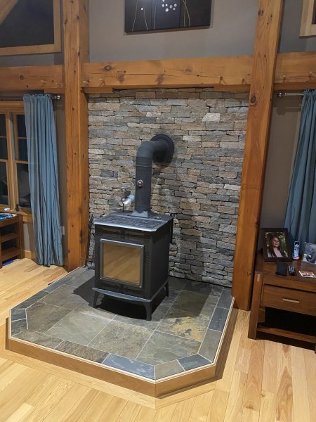

    EF82464F-95D6-4DDA-B420-1841A29E5679.jpeg That’s my set up inside.

    Oh man. Sharp!!!
    However, don’t mind me if I say that hearth deserves a WoodStock Progress Hybrid sitting there.
