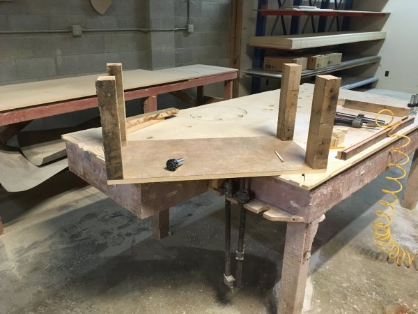

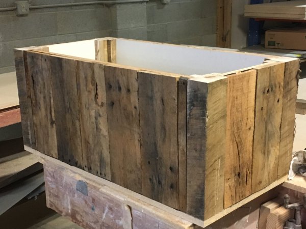

    I started with a Plywood core for a base which I laminated up with some scrap laminate. I also made side panels out of scrap laminate as well, that's why it is a different color than the floor a couple pics from now IMG_0057.JPG

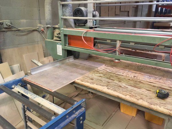

    Next, I squared up my base on my beam saw, so I know I am working with something square from the start and with clean edges. IMG_0061.JPG
    Next I of course tore apart a whole bunch of pallets and found the easiest way is to cut between the slats and runners with a sawzall and metal blade and just leave the majority of nail heads.

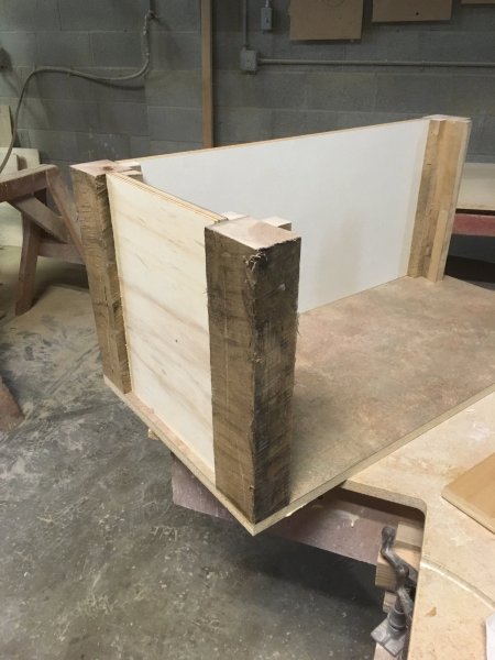

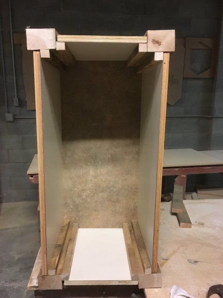

    I then took a couple of solid pieces from a heavy duty pallet approx 2" x 2" and glued and nailed them to my base
    I figured out my thickness of slats and plywood on the sides and and set back spacers and nailed them to the uprights to hold my plywood at a specific depth to flush out my sides. IMG_0067.JPG
    When I was done, I had my assembled box with laminated interior and the exterior was spaced to fit approx 1/2-5/8" slats.

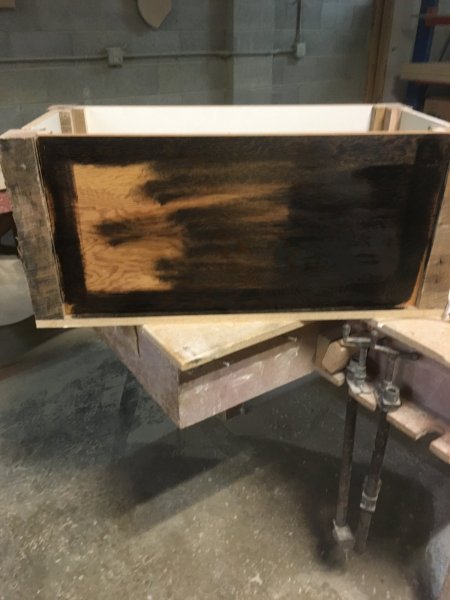

    I then went around the box and used a dark min wax to stain the boards dark so that any gaps between my outer slats would not show the raw wood beneath.

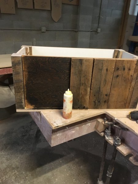

    I then went and started dryfitting and adjusting slats to the outside for fit and coloration on where the most exposure is going to be in my house. As I get a side I like, I glue it up and nail it.
    I continue around the box until it is done on all four sides.
    Between my base being "perfect" and trying to fight a couple boards along the way, I am only a 1/16 out of square across the approx 36" x 18" box, I was pretty surprised by that with the rough cut pieces I was using.

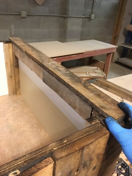

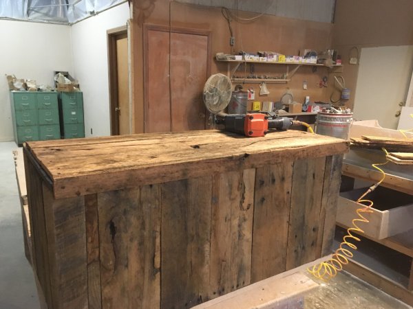

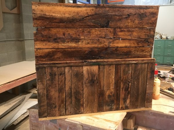

    I then stained the top edges of the plywood and began to cut a " cap piece" for around the top edge. Also below it on the back I put solid pieces where my hinge is also going to be mounted for some extra meat to screw into.

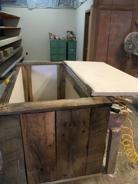

    Then I attached the hinge to my box then to a piece of plywood to fit inside the box.
    I stained the edges and tops and bottom of the board and attached slats to the top and an overhanging piece on the front as a "handle".

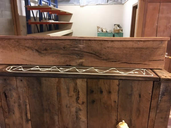

    here is a pic of my last piece of the top and "handle" you can see the shiny side of the nails I cut off. I tried to leave as many rusty ones on the outside as I could.
    Next I attached more slats to the inside to cover the plywood on the bottom side as well.

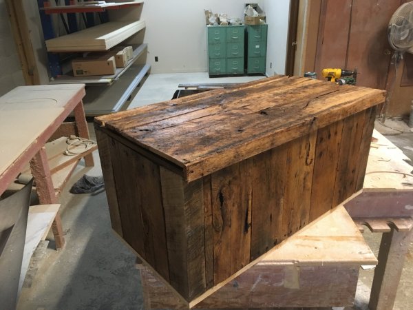

    Finished Box ready for finish.
    Not wanting a shiny finish and not worried about brush strokes on this item, ( I am used to perfectly smooth finishes on cabinetry so I am used to spraying laquer to mimic catalyzed clear coats on our brand's factory finishes.) I used this water base matte finish with a cheap brush.
    You can see the right side is done and is definitely bringing out some character.

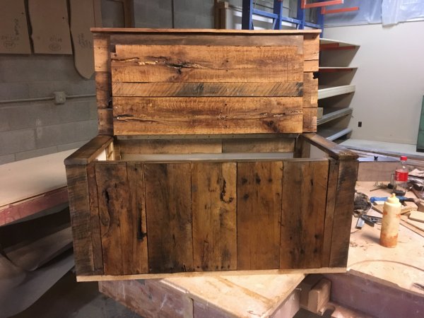

    A couple more coats on everything and here it is.
    IMG_0090.JPG IMG_0091.JPG IMG_0092.JPG Also, before someone points it out, I know you will see the plywood at the base when it is in the room. What I did that barely shows on one of the photos is poly'd a couple of 2 1/2" boards to match. I am going to put it in the house and make sure it is level. If not I have screw adjustable leveling legs that I can attach to the bottom and be able to screw the corners individually and level. Then I will attach the "base board" pieces around the base and cover everything else up and have the base level to the floor. I laminated the interior so that it was easily cleaned with muddy boots and so water won't absorb and discolor anything. I used silicone on all the seams as well on the inside. All in all, this took me about 3 1/2-4 hours and about $15 in finish, but I have a "free" shop with plywood scraps and equipment that saved me a lot of time that most people don't have, so your mileage will vary. Up next in a few days is the entertainment center I am hopefully finishing tonight.

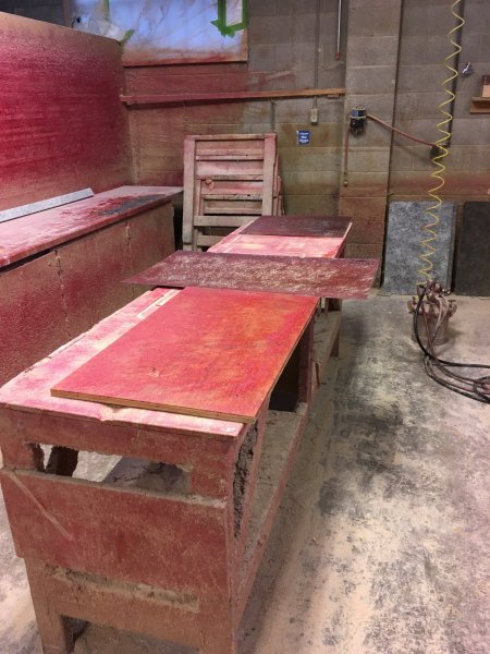

    The shop is much larger than I usually ever need but I have it and the building has been paid for forever so it just costs utilities and taxes. The shop section that were in a couple of the pics is about 30' x 125'. I am thinking of knocking down another wall that used to be an office to add a bit more but rarely do I ever need what I have now. We have gotten away from some of the fabrication/ finish work we used to do in house years ago, but when I need a tool, it is nice to have all the equipment sitting there and in quantities. I think of selling stuff sometimes, but then I get a use for an 6' bar clamp and I have 20 of them on hand, so I always end of thinking about the "someday I may need this again" situations.

    I like the beam saw......is it tough to keep square?
    Is it adjustable for angle cuts? I'm intrigued.
  13. chbryson
    chbryson
    Oct 6, 2014
    201
    767
    The aluminum pieces are the guides. Each side locks at 90/ 45/ 22 1/2. The saw is about 1/64th out of square in about 8' which for my business is well beyond good. The saw is great for doing mitres and having 2 "perfect" pieces to match up at seams in counter tops

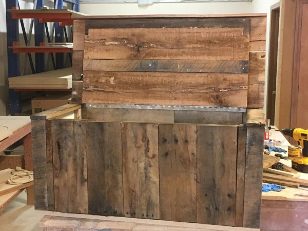

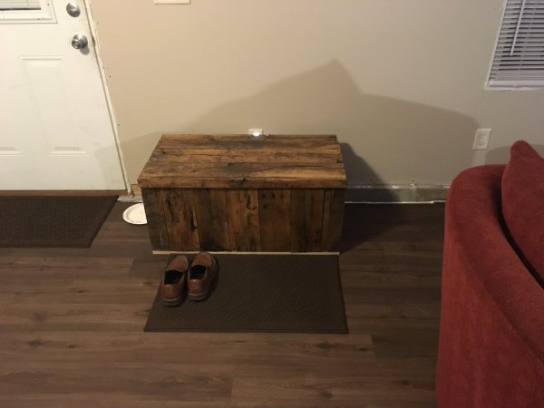

    I don't have the base board around the piece yet (or in most of the house right now) but here it is sitting in place. I have a coat rack/ storage cabinet that will be hung above. I will get a finished pic when everything else is finished up too.
    brenndatomu, savemoney and Woodwidow like this.

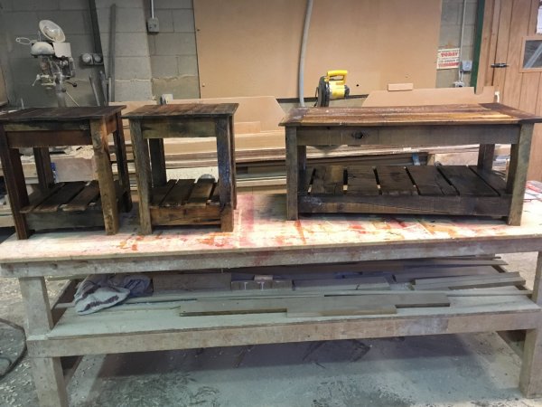

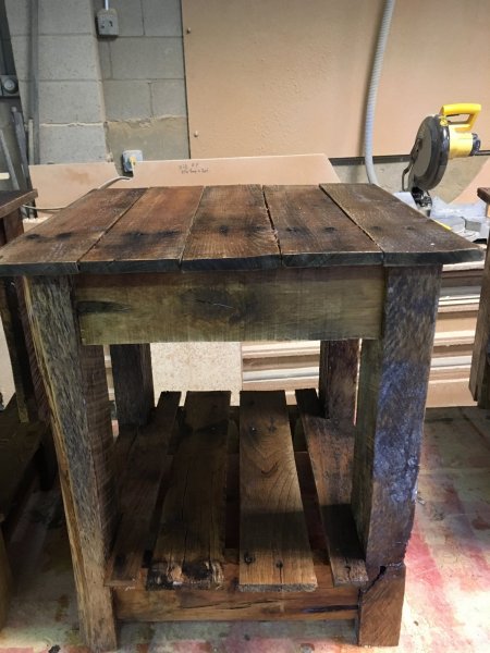

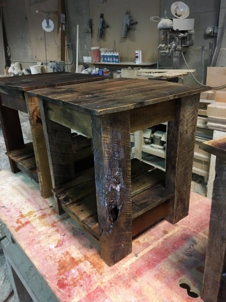

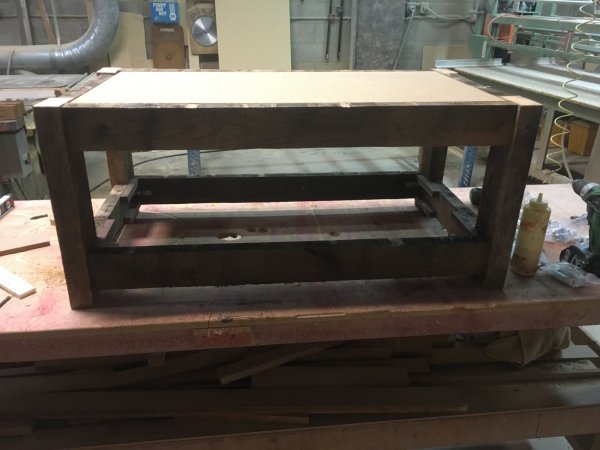

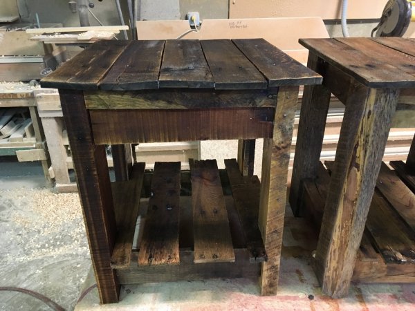

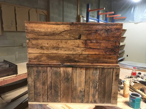

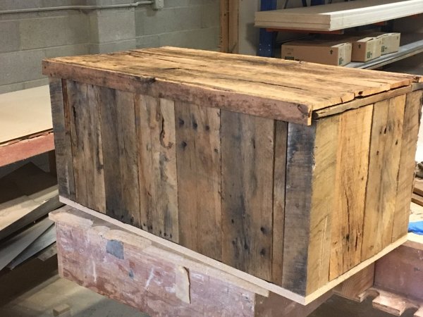

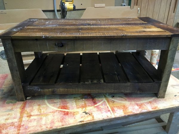

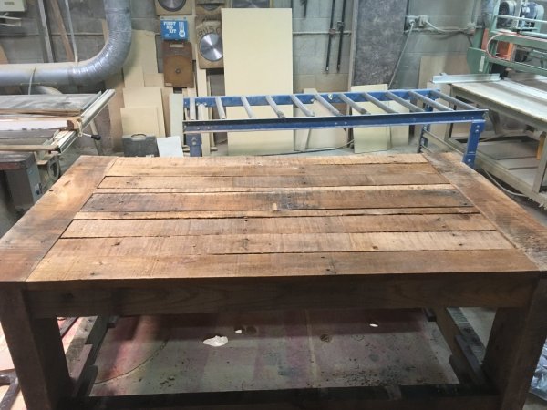

    IMG_0538.JPG IMG_0540.JPG IMG_0546.JPG IMG_0547.JPG IMG_0548.JPG IMG_0549.JPG IMG_0550.JPG I have been stockpiling some more pallets since my last projects and had some time this weekend so I went ahead and made a coffee table and end tables. Not as in depth of a build but here are some pics.

    The white on the boards in spots is because the pics are right after I finished brushing on the finish and it is wet

  19. papadave
    Water based Poly?
