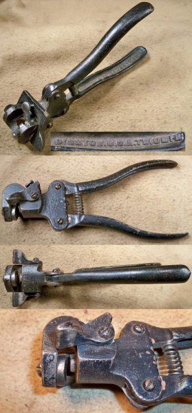

    These are 2 of the most common styles. The ''pliers'' style are normally used on smaller saws used by furniture/cabinetmakers & carpenters - saws from 6 to 18 teeth per inch with blades 6 to 28 inches long. The large saw "wrest" on larger 1 & 2 man crosscuts used in felling/bucking green wood.
    Back/tenon & mitre box saws are finer 10 to 18 point.
    mdavlee, Stinny and jetjr like this.
