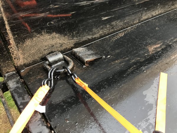

    91ED7262-4F2F-419B-AD8D-37AE5792E5E9.jpeg I just modified our new Delco Trailer’s trailer with little ramps just in front of the back cargo rings. First loads would hang up and bridge splits almost to to top front side of the bed. It was not safe to grab a keystone split and try to make it all fall. It works so good it dries my tears from sanding through the perfectly new powder coat to weld the ramps on. And it safer. Be safe my friends.

    Nice. That saves a lot of work!

    I’ve been thinking about putting D rings in my dump. I was thinking of mounting them down low on the side in hopes they were less in the way of dumping loads. Either way that’s a great fix for the problem. Good thinking. I’ll keep that in mind.
