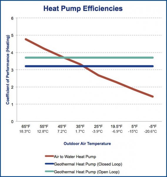

    some good points to consider, especially which size unit to purchase for a cold basement with no/little available waste heat in the Winter:
    Heat Pump Water Heaters in Cold Climates: Pros and Cons
    I've considered a coil of copper or a tank over a drip pan in my attic for Summer use with drain backs to empty it in the Winter .
    CHeath, wildwest and Eric VW like this.

    Im certainly no expert but I think this may be a bit misleading. The HP will work at the max efficiency possible at any given temp. The efficiency or COP will go up and down with the ambient temp...
    CHeath, bushpilot, wildwest and 2 others like this.

    Yes that was the disingenuous answer. The max efficiency at 50 degrees is not the same max efficiency at 100 degrees ambient. That was a salesman answer and not an engineer answer.
