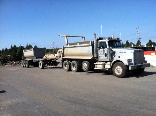

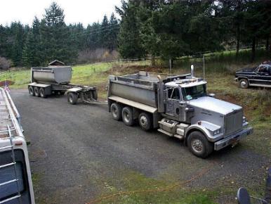

    The jake is an awesome helper.
    Back when I was into heavy trucking I owned and ran a Western Star withe a 500 Cat in it.
    I could come off a 6% grade loaded up to 105,500 pounds and never touch the air brakes..
    Ran a big rig up until 2012 when I retired...
    500 cat...18 speed Ranger tranny..
    Fun rig to drive...
