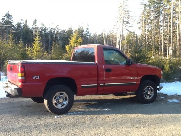

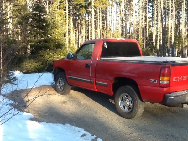

    Thinking about buying a truck. I'm a truck virgin:emb:, never owned one. This will be the fourth vehicle for our family so I don't want anything fancy or new, just want the occasional functionality of a truck, it might see 6-8K miles a year. This is my boss's old truck that he is willing to sell me at book value. My boss is a "car guy", and a friend so I know the truck is in good shape and he is not misrepresenting it. I'm bringing it to my mechanic to take a look at it today. What I don't know is if there are any known issues with this truck/engine/tranny or anything I might need to know about this truck. Thanks.
    Could you put a plow on this truck?
    It's a 2001 Silverado 1500 LS with the z71 suspension package, 6 ft bed. The engine is a 4.3L v6 with a 5 speed manual and 4WD. Current book value is $3400. Mileage is 133K.

    Rust- check the underside, especially the rear, fenders above the gas tank, brake lines etc.

    The 4.3 is a good motor, but undersized if you want to do any kind of towing over 4-5K lbs. The short wheelbase will further limit your towing capacity.
    If you're just looking for something to haul relatively light stuff (lumber, drywall, firewood) then it could be a good option. If you are looking for a tow rig in a half ton package then you should keep on looking.
    Plowing is hard on trucks, especially half ton trucks, and double especially on half ton trucks with tall gears, and triple especially on manual transmission half ton trucks with tall gears. Since this is a short wheelbase, depending on the plow, it might nose dive more than you'd like since there isn't enough "azz" behind the front axle to offset the weight...a lightweight plow might be fine though.

    I would consider it a nice first truck. If you are planning on hauling a decent sized boat or other heavy trailers, or doing snowplowing for a living I would keep looking. For light trailers, driveway snow plowing, firewood, and the occasional refrigerator or other home appliance/furniture it will be great .

    One thing you'll discover immediately is how light the rear is on slippery roads. Short wheelbases add to that. Weight in the back is very helpful. If you put a plow on the front, which that truck will push, that "light rear end" is even more noticeable. Fisher has some light plows that are worth looking at. Have fun DaveGunter Every one I've ever met who buys a pickup for the first time, says... how did I ever get by without one... :yes:

    DaveGunter , My first pick-up was very similar and the light tail does slide. When winter came I put some sand bags in the back of the bed, right against the tailgate. Put a board in the slots so they would not slide forward on hard stops. Made a world of difference. The sand also came in handy several times to get cars that were caught on ice moving again.
    I still think it will make a good first truck. After a couple of years you may decide you need more truck. By then you will have some "truck" experience and you will have a better idea what you are looking for....
