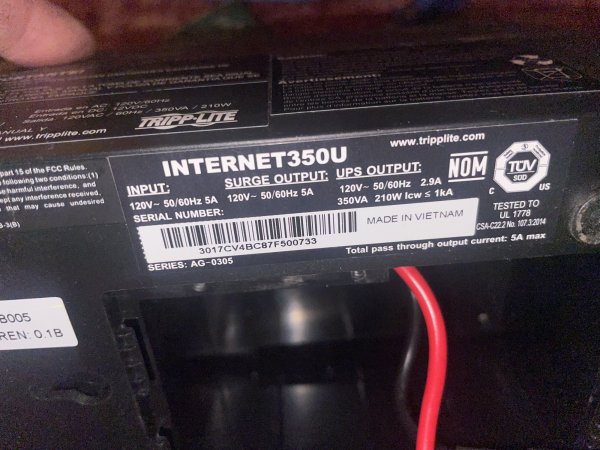

    The Tripp Lite Internet 350u alarm sounded and no power to the computer. The circuit breaker tripped and would not reset. I had to unplug the unit and disconnect the Gel Cell battery inside the unit to stop the alarm.

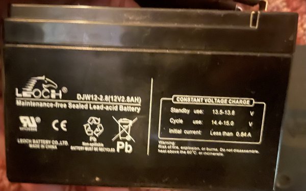

    The gel cell is a DJW12-2.8(12V28AH)
    Checked with Batteries Plus and their 2.9 AH replacement battery is too big so it maybe better to go with this and they carry replacement batteries for it too?

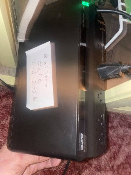

    This time I put the new battery date 02/06/2026 on the side of the unit since they last about 2-3 years

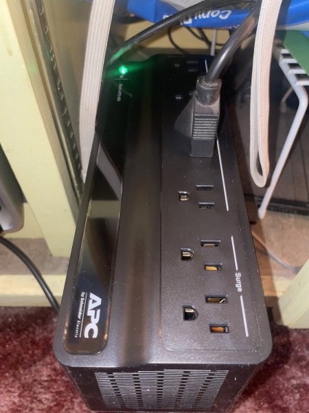

    This is the model of the new APC
    APCBN450M APC Back-UPS BN450M 450VA 6-Outlet UPS Battery Backup and Surge Protector

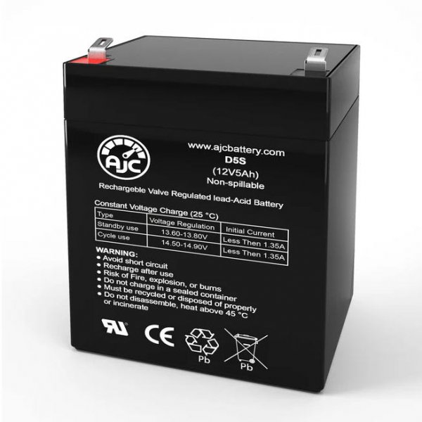

    The Gel Cell APC Battery for this UPS is
    AJC D5s 12v 5AH
