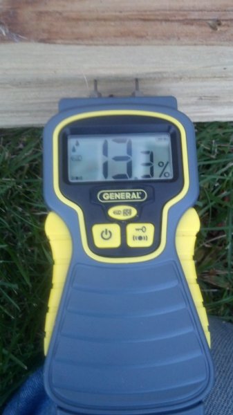

    I finally got a MM after years of denial. Reading in fresh split inside surface of the fattest, heaviest BL splits that sat stacked 2.5 years. Stacks are single rows separated enough to drive between, windy spot with little shade. We hope for GBE (good burning experience) this winter. IMG_20131010_185817_561.jpg IMG_20131010_185755_412.jpg
    This BL finally feels right (weight and sound - drop it on concrete floor = "DIINNNGG"). Some ash C/S/S for a year measured at 15% to 22% is also staged for this winter. I still don't completely believe in these MM's, so will report back mid-season on how this wood really performs. Thanks for this cool site and everyone's great posts.

    You've got that wood in the sweet spot of moisture content. Should burn very well.

    Gark, if you did it right, and that thing isn't lyin' to ya', you should be a happy camper this winter.
    The true test of course, is how it burns.

    Mmmm, 13-15% BL is about enough to make me drool. I have about 2 cords in the stacks that checked low 20% range last winter. Test burned one load and let the rest sit another summer. I had about 2 cords three years ago that was blow down from 1998. It checked 11-13% and was the best burning wood I have ever fed my stove. It still holds all the records for my stove including 18 hours 250-250*,28 hour relight without a match, and >650* for 4+ hours with the primary full closed.

    So ! what do ya think now ? Do you like using the meter?

    Yeah, the meter confirmed the samples' other characteristics (weight, sound, smell) and that the palm of my hand is 34% MC. It satisfied my urge for gadgets and will be used by a good friend who is a beginner wood burner to help guide him through the journey we all take. I like it.

    Mid-year report. This is the best year burning yet. The 3-year plan and MM both work.
