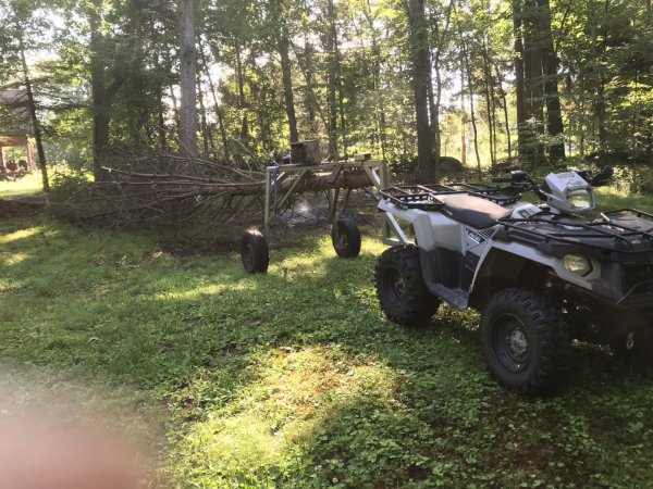

Well not a full tree. I tried but it lifted the rear tires of the atv off the ground. Occurred to me instead of limbing everything where it fell I’d be better off moving it to the fire area then cutting it up. Less cleanup, less work. Third pic is the second tree I took down. Definitely front wheel drive

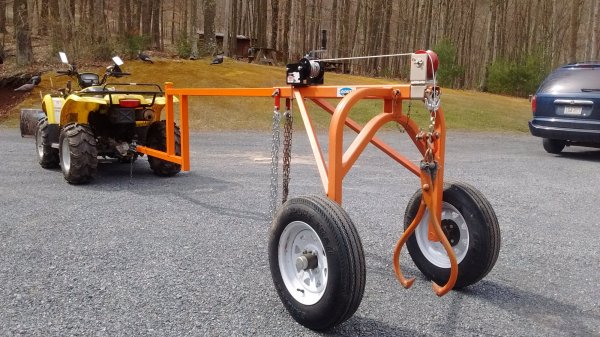

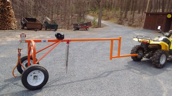

I built a new arch with a longer removable tongue. Over 10' from tong to step down at the hitch. Have carried 20"+ x 20'+. ATV handles it very well.

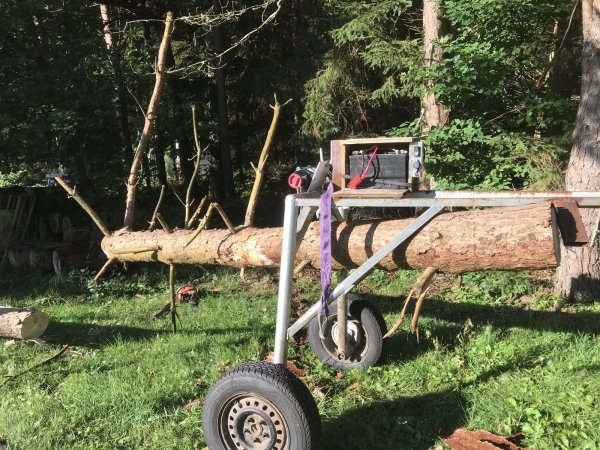

Can you pull more of the tree into the arch and get the butt end strapped to the rail that has the ball hitch on it ? May not be the proper way to carry a log but you have a tree.

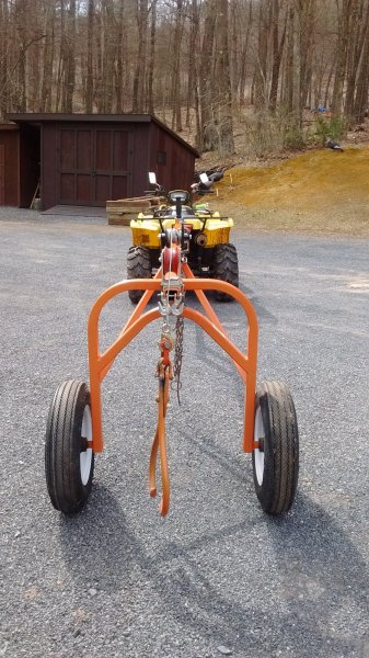

Mine extends further also. Never tried it, don’t know how far. Didn’t build the original arch just installed electric and tossed the handcrank.

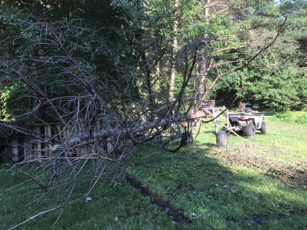

Yes you could do that. Not really worth the trouble of course but it could be done. As is the arch will tolerate a very large amount of off centered weight extending off the back. In fact it relies on the log being off centered in order to use just one picking spot. Obviously I went too far beyond that point LOL. There are several ways to amuse oneself but only one way to learn the limitations. It was like a 40-50 foot tree picked about 5 feet from the base. That’s a lot of weight to pick extended like that. Easier to just make two trips.
