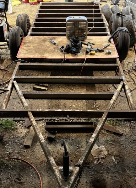

    I have been working on one of the tandem trailers we have so I can haul the skid steer and some wood while we get the truck engines rebuilt.
    It used to be a camper and we pulled the shell off of it. I’m welding in semi crossmembers about every foot. They are a little rusty on top, but still pretty solid. I’ll mill up some Doug fir for the deck.

    They are pretty light duty in bare form, because the body makes it rigid, but you can make a respectable trailer with some work and welding. This one is rated for 7k, and it will haul that all day. I got the rest of the crossmembers in today. I kept them pretty close together between the axles and at the tail, and spaced them out more at the nose. I probably don’t need anywhere near this many, but I had em so I figured why not use em. They weigh 16 lbs each, so a few extras won’t hurt anything. (I probably used twice as many as I actually needed) It sure is rigid with everything welded up. It hardly moves when I jump one one corner.
    I am going to put a set of pallet fork loops on one side in front of the fender so I can carry my forks out of the way. That leaves more space on the deck and is one more thing I won’t have to tie down.
    I am thinking of putting some 1.5” square tube on top of the frame rails to stiffen them some more. They are 4” channel and close to 16’ long. A bit more depth would only do good things for it. The deck boards would sit right inside the square tube.
    I picked up some tires today. They are only a couple of years old and look pretty much new. They were $100, so I jumped on them. I also got 6 nice safety gas cans for $5 each! I still have to get a couple of tail lights and run wires. It will be much easier without the deck on it.
    We might mill the deck boards tomorrow. We can get them all out of a 14-15” log, so it won’t take long. I have a few specimens in the stack that would make really nice deck boards.
    I am trying to keep the trailer weight under 1,200 lbs. The crossmembers weigh pretty close to 250#
    The deck should weigh about 400#
    The axles are probably 250#
    The frame weighs about 220#
    That makes 1,120 lbs, so I should be pretty close to 1,200 when it’s finished.
    Technically, I don’t NEED ramps, because the trailer is easy to tip up so the tail sits on the ground, but ramps make it easier and safer to load and unload because the trailer can stay hooked up, so I will make a set.
    I’m going to check the bearings and brakes when I replace the tires. The brakes will most likely need to be replaced. The drums should be fine.
    I have used the trailer to move stuff already. I used it when we got the new firewood conveyor and when we hauled lumber for the deck on the house. It pulls great and it’s easy to forget that its there. I will have to get another brake controller, for the van. I have a tow pro liberty in the truck and LOVE it. I can pull my brother’s 14k equipment trailer and the liberty makes it disappear.
    I’m so excited to get this buttoned up. The only real costs will be the tires, brakes, wiring, and the frame stiffeners IF I decide to use them. The rest is all stuff I already have or can make.

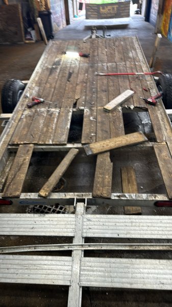

    Boss asked me to strip his aluminum trailer the other day. Needs some welding as there are a few cracks. It’s was in rough shape.

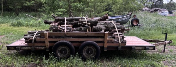

    The trailer hauled its first load today! We got the stake pockets welded on, checked and greased the bearings, checked the brakes (they look pretty good for 50 years old), and welded the safety chains on. It pulls like a dream and the van doesn’t even care that it’s back there. We picked up a little over 2 face cord of maple and oak. We have to go back tomorrow for a second load.
    The guy we got the wood from had a small tractor with a loader and he loaded some of the bigger pieces for us. He dumped the first load of rounds on the trailer and they hit end down, perfectly flat, BOOM! The trailer didn’t flex at all. It was AWESOME! We got it loaded with about half of what was there and came home.
